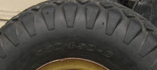

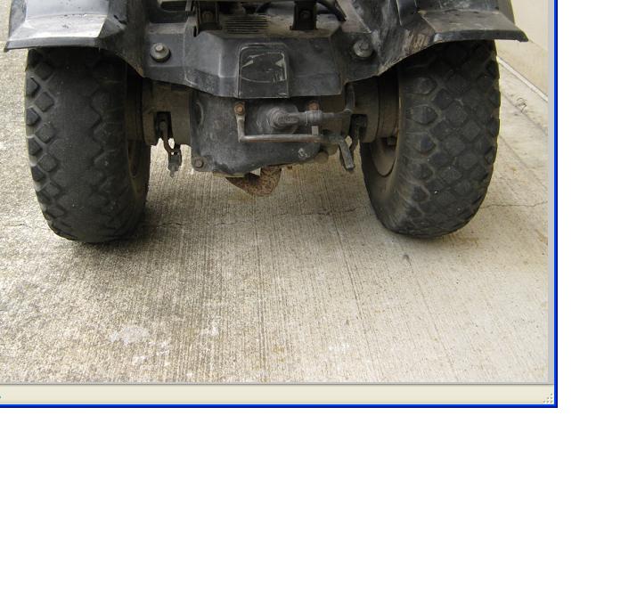

Bradthree found a good replacement size - 5.30 x 4.50 x 6. Thanks Bradthree
A recent Gyro purchase came with a set of 5.30 x 4.50 tires. Dia and width wise, this is close, and fits under the stock plastic. The tire label says "HWA Fong", along with "Not for highway use".
Search around for a good price/tread/mfg. Links below are just examples.

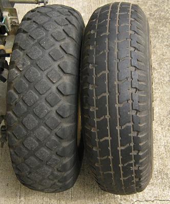

Pic below shows a worn OEM Dunlop tire on the right.
