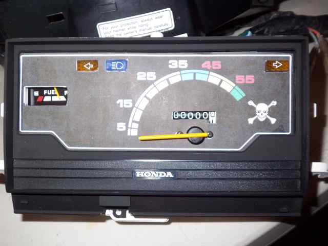

Or you could just take it apart .
And not tell anyone.
Wow my 15 year old Elite has no miles on it .
I also re-did the face plate ,I guess I should have put in ( may not be actual mileage )

- 100_3006.jpg (25.73 KiB) Viewed 4558 times
- 100_3009.jpg (24.4 KiB) Viewed 4558 times
- 100_3012.jpg (27.28 KiB) Viewed 4558 times
