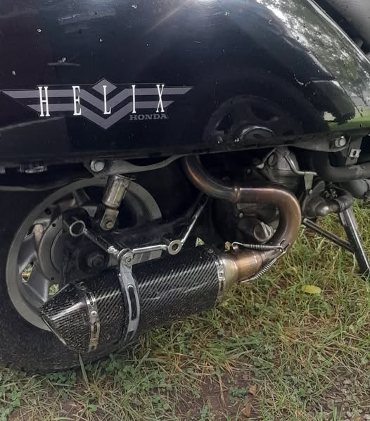

No, the gasket is still available from dealer, however it is double the price of aftermarket gasket. Trouble is, the aftermarket gasket is slightly too long for proper fitment, and gives big trouble when trying to reinstall muffler. Upon further examination, I find that the PO used an aftermarket gasket on this helix, failed to get it to align, and left 3 mounting bolts out of muffler. this has led to a complete failure of the gasket connection, and rendered the muffler junk when 2 of the 4 tabs that "pinch" the connection have broken off. I have a custom exhaust ordered. Update to follow.

Installation of custom pipe complete.
Good throaty sound, easy fitment.
Turned out very good. I'm happy to be back on the road.

No audio, but here's a pic of the Bonanza pipe.
It's straight through, so pretty throaty.
