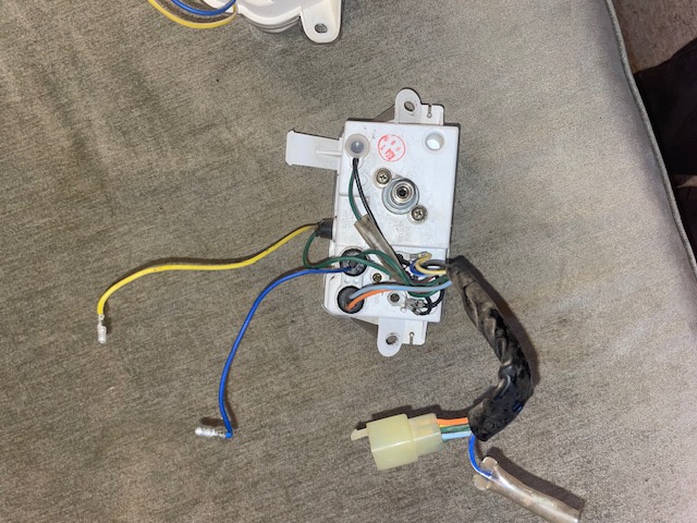

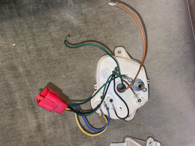

by Caspervolas
Top is the eve, bottom is spree. I can match most of the wires up with new connections but I have no idea where the brown and green wires on the eve speedo go I cant find anything in English about it either. There are clearly a lot more wires coming off the spree, do I just match up the wires and connect what I can and have unconnected wires?

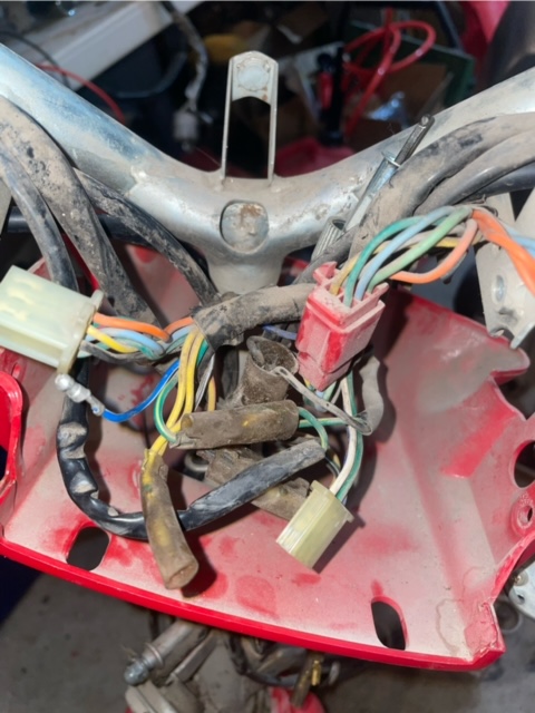

by Caspervolas
And here is the wiring on the spree itself, kind of hard to see what's going on.

by bonesv
Ok, I see what you have. So you are not concerned about having a fuel gauge then? Yes, go ahead and connect the wires you can make out for the lightsand the other ones then will be the fuel gauge and turns. You should be able to figure it out from there. Make sure you get all the ground wires correctly connected. Keep it neat and double check your work. Good luck my friend! Bones

by Caspervolas
Do you have any idea what the green and brown wires on the eve speedo are?

by bonesv
Caspervolas wrote: Mon Jan 01, 2024 1:28 pm Do you have any idea what the green and brown wires on the eve speedo are?
I suspect those are for the oil level so when your oil gets to a low level it turns on a red warning light on the speedometer panel. I'm pretty sure the yellow and blue wires are for the fuel level gauge.
