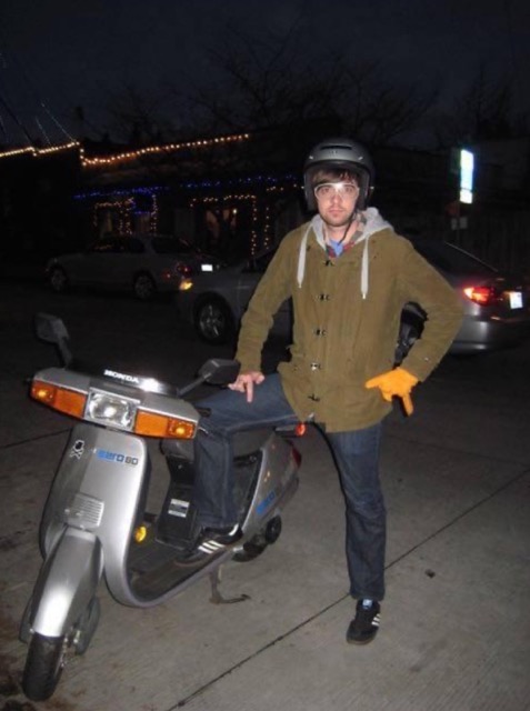

ORIGIN STORY
I had an Aero 80 back in 2014 (I think it was an '83), and loved it. It was pure joy riding that thing around, and I never had any mechanical issues.
Scott and Aero 80 - 2014 Medium.jpeg (55.02 KiB) Viewed 17254 times
I lived in an apartment in a densely populated area at the time, so I had to leave it sitting out on the street all night. And was stolen, twice. The first time, I found it a mile or so down the road, the plastic body around the ignition had been broken away and presumably it was hot-wired. I brought it back, and then it was stolen again a couple months later.
I moved into a house with a garage last year, and have been thinking about getting another scooter ever since. I was thinking about it last weekend, hit craigslist, and lo and behold found nearly the same Aero in pretty nice condition. I test rode it, got it up to 42mph, all seemed good to go, and bought it.
