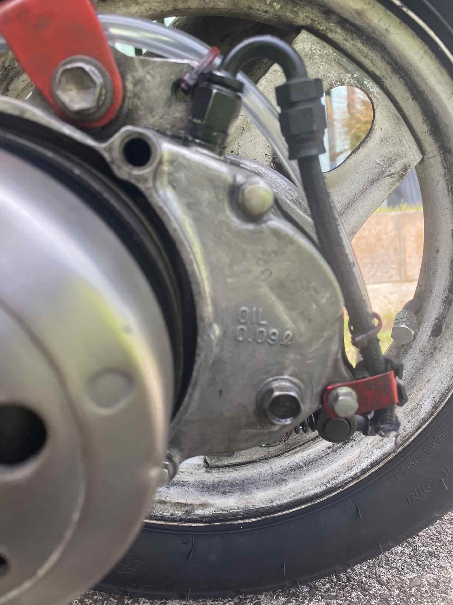

I recently got a DD50 with a spree engine in it?
It’s a polini/malosi bore 72cc I’m pretty sure.
All the bored I’m finding for this motor is a curved exhuast ear but mine isn’t?
Bike hits 65-70mph (not sure how)

If it has a Polini/Malossi bore and it hits 65-70mph, I give you my personal guarantee, without a shadow of a doubt and with 100% certainty….it is not a Spree motor.

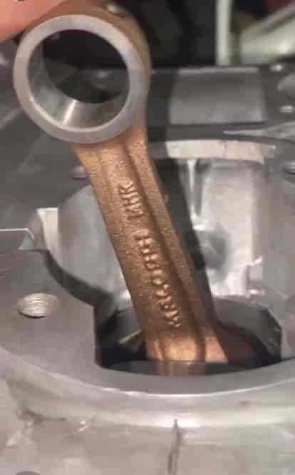

Just found out my setup on my bike.
Installed a new polini corsa kit.
2AB mini stroker crank
AF16 short case
AF05 long block
Thank you all for trying to help

Its probably an af16e or af18e with an af05e rear trans cover...

was previously running a 2AB but switch to a MHR stock stroke

also someone said it was a variated af05e, which i believe it is

sum_azn_kid wrote: Thu May 18, 2023 5:13 am Its probably an af16e or af18e with an af05e rear trans cover...
i think this is the correct answer to what engine is in this guys scooter. looking at that last pic he poste, 2 thingsverified that its for sure not a spree af05. 1, it has a 4 bolt reed block intake, spree engine only has a 2 bolt. 2. those case ports are 3x the size of spree engine.
which way does your kick starte does amr go? does it face backward or forward? from the shaft that comes out of the cover?
