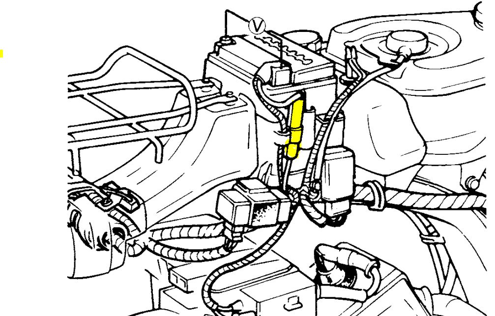

For the 85 Spree, can someone post a picture of where the actual fuse should be located? I looked at this one I just picked up and could not find one coming off the positive battery wire.

mousewheels wrote: Mon Oct 11, 2021 12:54 pm
Excellent thank you.
So I definitely did not see that when working on it the other day. What type of fuse holder and size will need to be spliced in there? Any idea if this is potentially a cause of no signals?
This site has the Honda Spree Service manual at this link viewtopic.php?f=11&t=37
You'll want the wiring diagram and part location info within.
In the SVC Manual Section 15, (Electrical section) the wiring diagram shows a 7amp fuse.
You can use most any inline fuse holder that is rated above 7amps.

Thanks I’ll check on this tomorrow and see if that flasher is getting power, if so will do like you said and check the switch. Also going to order a new inline fuse holder and wire that in where it should be. Really hoping the electrical on this hasn’t been messed with to much.
