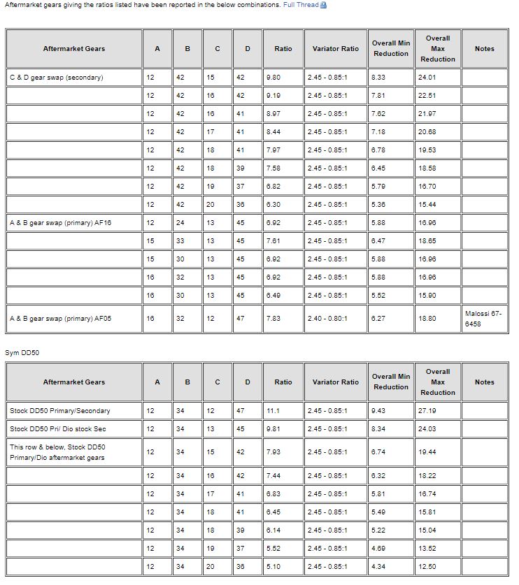

More specifically, am trying to figure out gear options on a SYM DD50. Recall any aftermarket secondaries drop final drive pretty significantly, but would really like to know by exactly how much..

hot dam! with some creative sleuthing, was able to find the info I was looking for!!
Used "thewaybackmachine" and a snapshot of an older wikispreedia, and wala!
https://web.archive.org/web/20171021045 ... ion_Ratios
:woot:
of note, wikispreedia is alive and well to visit this way. at least the pertinent info is there. wahooo

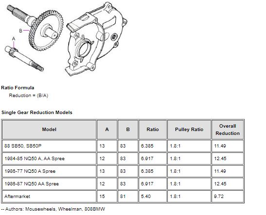

Re: Transmission Gear Ratios - MIA..
Hi and Fine work BToast :thumbsup:
I grabbed pics to put into your thread -- just in case the archive site goes away or breaks...
