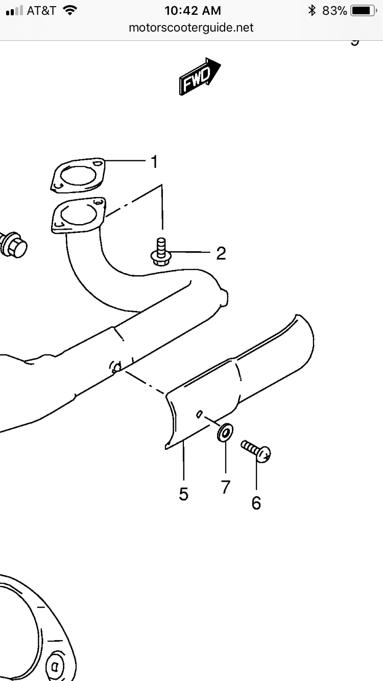

Re: There's a hole in my header!
Unless the hole you describe is the mounting point of a missing heat shield. Either way, should be plugged by a bolt..
