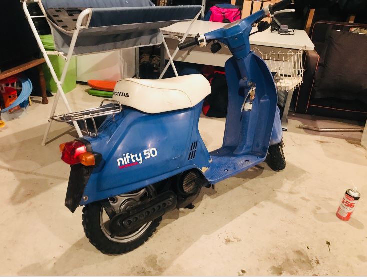

Hello everyone,
I have just picked up a 1984 Honda Nifty NQ50 which has been used a a golf scooter for the last 10 years.
I have no experience with these scooters so wanted to ask a few questions.
The scooter is stock standard apart from the tyres which have been fitted for use on the golf course.
I have been using if for the last 2 weeks commuting to and from work, only 3km.
1 - What would the expected speeds this scooter should travel. I am currently experience 40-44km an hour on the flat, 37-39km up hill, and approx 50-50km when going downhill.
2 - I am often experiencing slow take off speed (low rpms) and once the rpms pick up, it goes fine. How can this be fixed
3 - There was an issue with the oil tank, so i have disabled this and running a premix 40;1, is this ok?
4 - Are the horns on these scooters all high frequency horns that I would compare to a shopping checkout scanning buzzer?
Thanks for your help and look forward to any replys / help.
Ray

1. your speeds are pretty close to normal. When new and in tip top shape, you should expect about 50-52 KM per hour on the level and also when going downhill. Speed uphill depends on the steepness of the hill, but your speed is about right for a very steep hill.
2. the slow takeoff speed can't be fixed. There is no variator in your scooter, so takeoff is like starting in high gear.
3. yes, ok, but you would do better to get a used oil tank with no issues and use it instead of pre-mixing.
4. not sure about the horns in the New Zealand versions, but the U.S. versions sound like a beep instead of a honk.
Have a look at http://www.motorscooterguide.net/Honda/Spree/Spree.html for more info..

Your bike is a Spree, but the front plastics and turn signals are different. So for engine parts most Spree/ Elite E parts will work.

Eclark is right it's basically a spree with different trim. I may have a an oil tank if you need one. Maybe a horn too.
