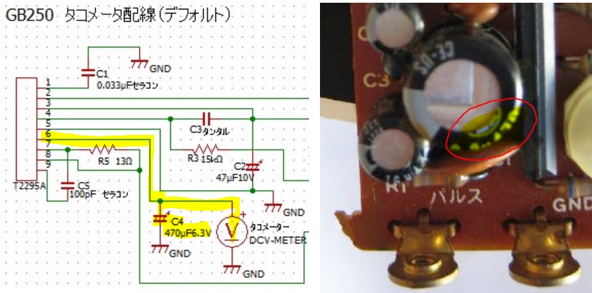

Here is a photo and schematic though wasn't requested. The key chip is the T2295A.

Re: Tachometer Questions
DavidB wrote: I used a square wave generator input to it and with DC positive and negative at the appropriate leads, got it to operate. It delivers 0-10 VDC from the PCB to the meter which then reads full scale.
There could be a schematic error, but I see the cap on the T2295A meter drive output (C4) is listed at 470uf/6.3v. Have you confirmed C4's voltage rating? If there's no schematic error, the meter movement is the primary issue.

Post by DavidB »
Mousewheels: Thanks for your observation. The next time I pull it out I'll check C4 out. I did run the Flush and the tachometer works, hesitating from 1000 rpm to then stabilize at 4000 rpm as MPH increases, engine RPM unchanging, which is supposed to happen with the variable speed transmission. Per bench testing it freed up. Meter movement is interesting, just not a simple spring with one coil.
