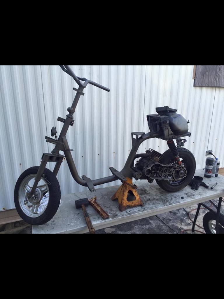

I have a af16 on a razz frame..just never finished it..used a af mount ..shock location was spot on..but like 1man8 said..the frame is brittle..many guys run razz with af16 in Hawaii..it's actually a really easy swap

It will be so scary to ride though :nervous:

Looks awesome!
