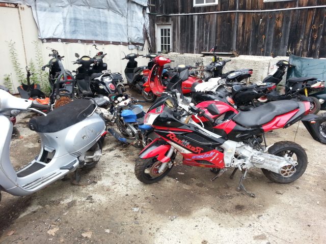

anyone know if Chinese disc brake and stem will fit 95 elite sa50?
Local Junkyard has a few Chinese scooters just wondering if any of them will work?

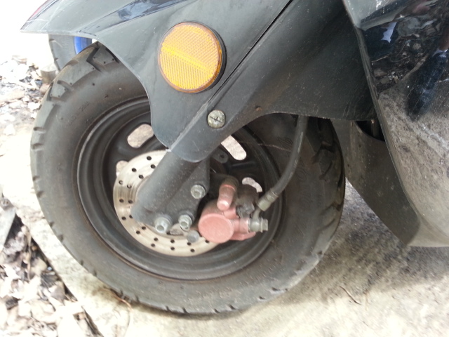

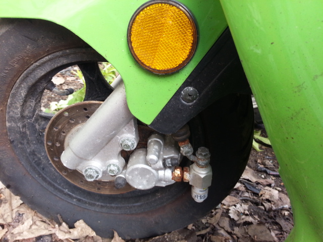

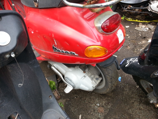

Maybe the black one with the single piston caliper? It would be nice to have disc brakes, but these may be junk?
Maybe the Vespa motor for a swap?

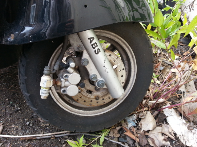

The (last one) red brakes look a lot like my dd50 brakes,

The vespa is a lx50, slowest 4t in the group.

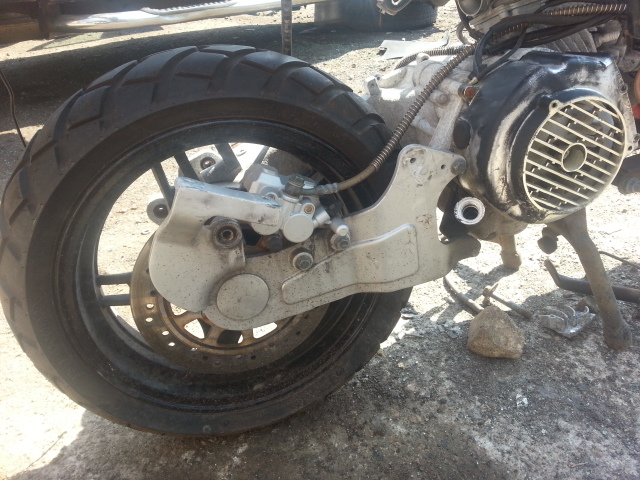

Rear disc brake
