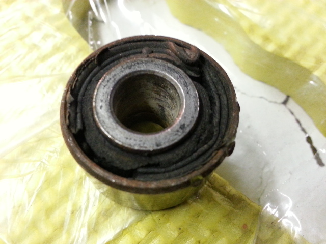

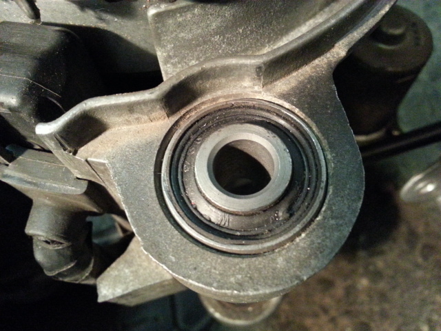

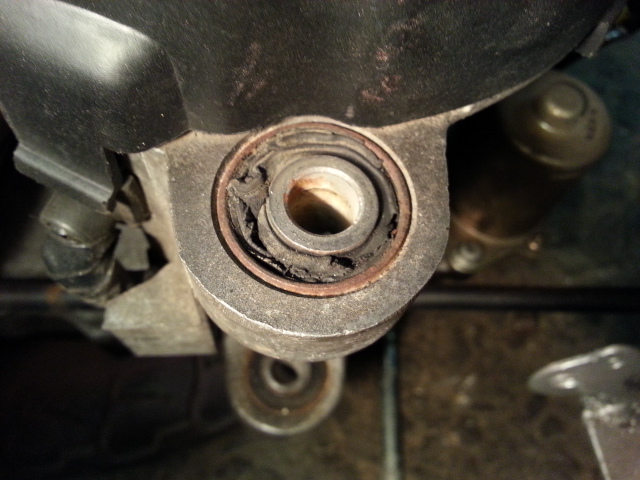

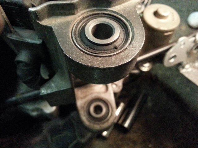

Hi forum. just wanted to post how to replace the motor bushings.
I ordered the bushings from graphite9. Great seller and fast shipping thanks
- 20141106_021851(0).jpg (137.56 KiB) Viewed 45664 times
- 20141106_022927.jpg (156.68 KiB) Viewed 45664 times
- 20141106_023831.jpg (181.2 KiB) Viewed 45664 times

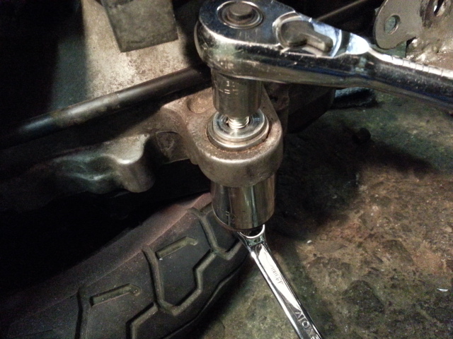

I used two different size socket and a 3/8" threaded rod.
A craftsman 27mm socket and a 13 /16 socket. your tools may be different
- 20141106_024012.jpg (156.48 KiB) Viewed 45663 times
- 20141106_024020.jpg (162.77 KiB) Viewed 45663 times
- 20141106_025420.jpg (164.4 KiB) Viewed 45663 times

Re: Replacing motor bushings

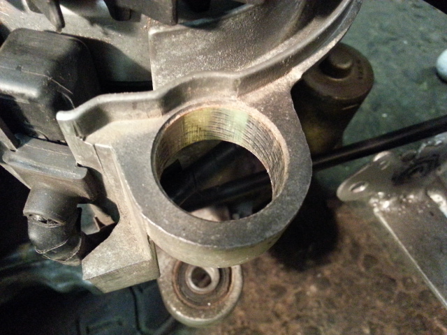

take your time go easy make sure it goes straight
- 20141106_030113.jpg (161.93 KiB) Viewed 45663 times
- 20141106_025435.jpg (155.46 KiB) Viewed 45663 times

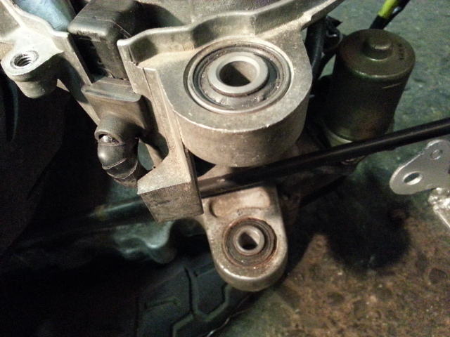

If the bushing is not coming out easy, stop. backout. line up the sockets and start again.
be extra careful not to pinch the cases, they can easily break. don't bang on them they will break.
Good luck
Nice-looking technique...
So the 27mm socket pushes on the bushing and is drawn into the 13 /16 socket?

Hi S4patrick. 13/16 into 27mmS4Patrick wrote:Nice-looking technique...
