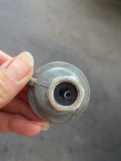

Thanks guys. Off to buy new hoses for fuel and vac lines. Meanwhile heres a photo of the top part of my petcock. Does it look ok? Lol i couldnt find any pic refrences. Anyhow i let it soak in gas. Comes out clean. I will update later

Re: Spree says 1/4 tank but doesnt want to start
When you buy fuel lines don't buy the cheap plastic clear line from the hardware store. It won't hold up to fuel more than a day or two with going hard as a rock. If you want clear lines go to your local small engine shop with the old lines and buy the matching sizes in the yellow tygon line. See though line is handy. If you can't get the yellow line go to Napa or an automotive supply. And get the good rubber fuel line. Napa has all of the different size lines by the foot. There should be a white plastic screen from the tank as well as that petcock. That is the most important part to clean as it keeps the e junk out of the petcock and Lines.

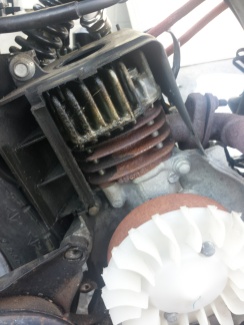

Ok im back. Took spark plug out and engine cover off. Oil everywhere including the plug hole. Does tgis look normal? I think not.
You can do it. We will help you
I wouldn't worry too much just yet. Sounds like a fuel issue. W
Like the carb runs out of fuel and isn't getting more fast enough. Or its soft seizing ( hope that's not the case) heres how I look at it. If it ran pretty good before the carb change and nothing else was touched chances are that's where the issue is. You can do the loan a tool at the auto parts store to use a compression tester. That's a god place to start.
