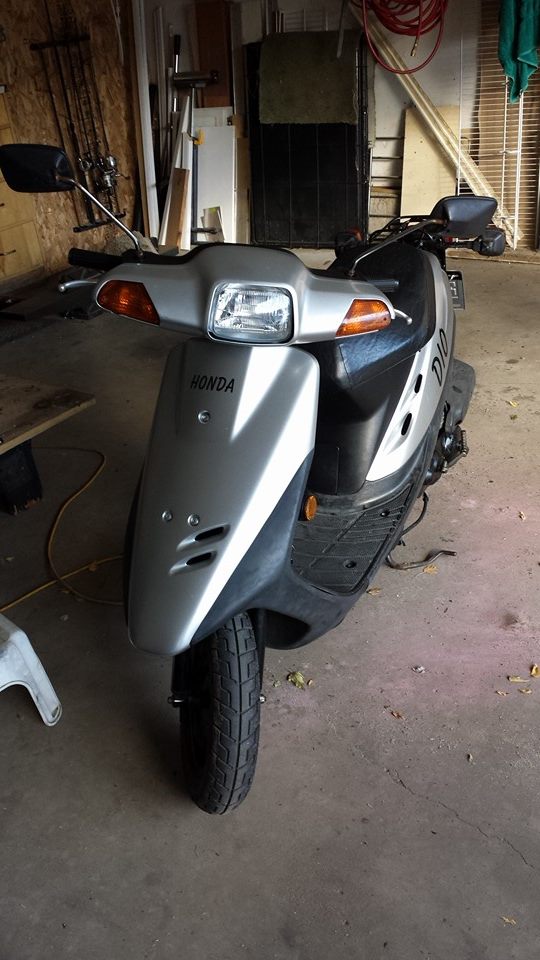

Here are some photos of my "Hogg"!

its a shame they didnt bring those into the states! bike looks great

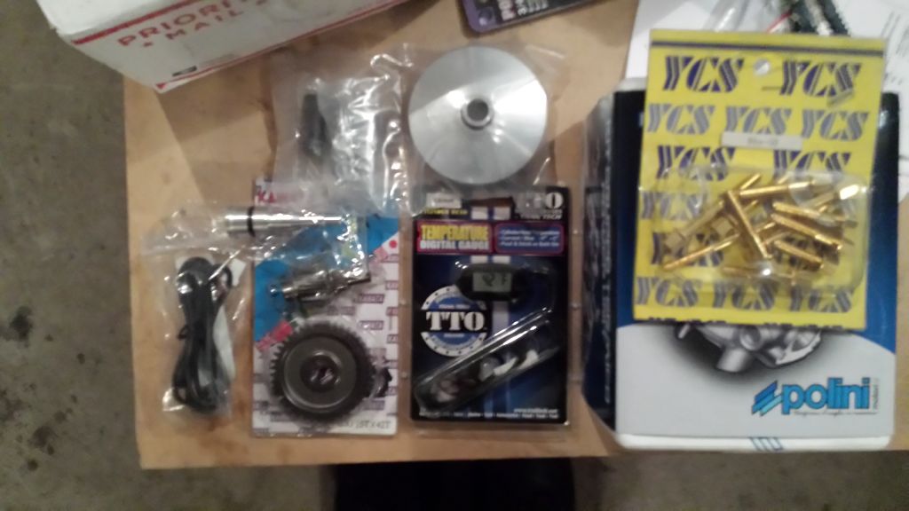

It was like Christmas today! I got my stuff from G9 and my other stuff from a cycle shop in Ontario!
My little city didn't have any good 2T oil, so I bought it on-line, plus I got a tach while I was at it.
Castor927, tach & mix bottle
Polini Contessa, Temp gauge, Polini Vari, 9.8:1 gears

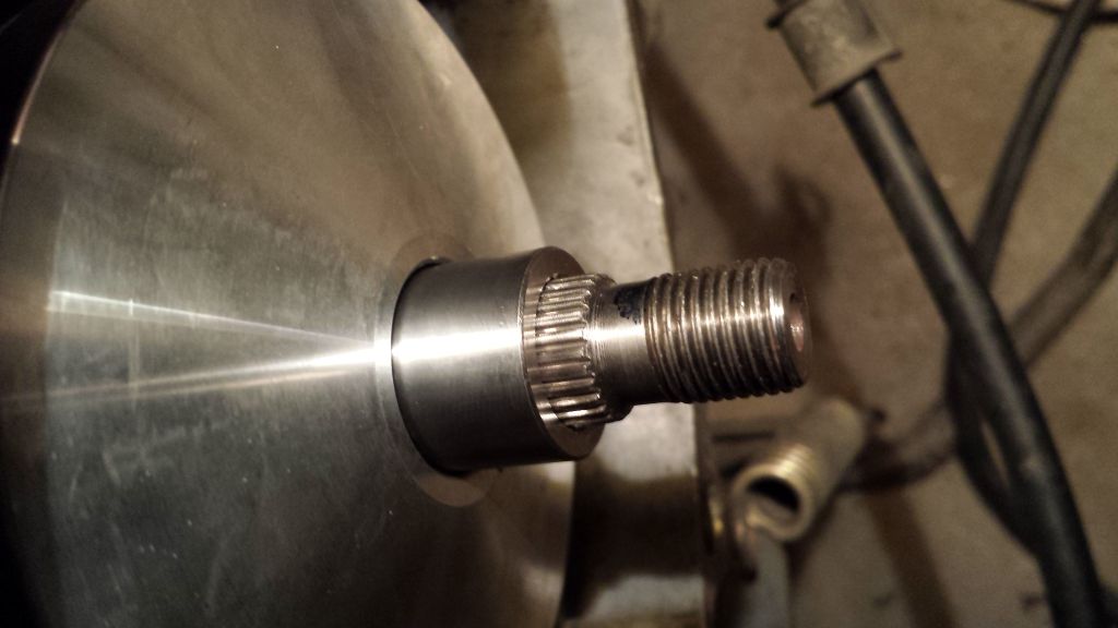

I did a dry fit of the vari and I think I have a problem. Seems that the Polini shaft is too long cause my outer sheave is barely on the shaft and my starter bendix barely reaches. Is this normal or do I use my stock shaft?? (though it would need a little sanding as it doesn't fit into the Polini inner sheave easily) See photos...
stock shaft.jpg (69.96 KiB) Viewed 16721 times
Polini shaft
Polini shaft

graphite9 wrote:Use the stock sheave on the variator. And the shim for your oil plug looks great! Your on the right path.
Graphite9: I'm thinking you meant stock shaft?? I'll have to sand the stock shaft to fit the Polini inner sheave.
