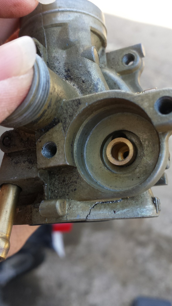

I took the carb off. Went to start cleaning and noticed a huge crack all the way through. Idk how that even happens. So should i buy a new carb off the wincycles site? I am ok with buying a used one but is it better to get a new one? Is the quality of those any good?

- IMG_20141019_135921.jpg (157.71 KiB) Viewed 12811 times
- IMG_20141019_135957.jpg (190.56 KiB) Viewed 12811 times
Re: Leaking gas 85 spree nq50
Wow never seen a carb crack like that. Also looks like the bystarter is broke too that brass piece shouldn't be there. Might be easier just to get a new carb but it will be a Chinese aftermarket and you will have to block off the oil inlet. If you can find a clean oem carb might save u some headache

You talking about the brass in the first pic? In the center ring?
That center ring is a part that belongs on the bystarter. If it stuck in the slot the way it did, you can bet that resin cemented it in, and the bystarter's little rod broke when the assembly was removed. The previous owner evidently overtightened the flange mount, causing the crack. You can see how it "folded over" the centerline.
The fEeBaY stuff reportedly isn't worth even the low price the vendors charge - you'd be far better off scoring a known-good Honda item from someone here who's removed it to fit something from the aftermarket.

What is the proper way to remove the bystarter? Should it just pull up? I wasn't the one who removed it but it did make a slight pop noise when removed. And right before that I was saying I dont know how to remove that.... I'll post up a pic of the end of that later. If its broken I wouldnt know. And that person wont be touching my spree anymore lol. This is the link I am looking at for the new carb http://wincycles.com/p1005/Honda-NQ50-S ... _info.html doesnt say anything about blocking off an oil inlet.

You can get spree carb bodies without any of the other parts and then you can just fit all of the parts from your carb with a new bystarter and off you go. The bystarter should just pull up and out of the carb after removing the retaining ring and screws. It must have been messed up and or stuck in there as whellman pointed out. I cant see any way to remove improperly unless it was forced sideways on pulling. It would have been real obvious if you were watching at the time and think.
