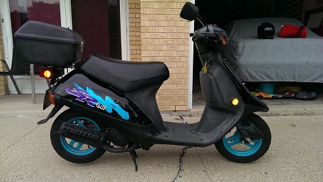

Hello all, my name is Joe and I recently picked up a 1993 Honda SR50 scooty with 1085 miles on it. I noticed the oil is low and in the storage compartment the previous owner must of been using semi-synthetic Lucas 2 cycle oil. The oil color in the scooter is red and the lucas oil is greenish. I assuming I should drain the old oil and replace it the lucas brand? Not sure if the previous owner was mixing 2 different oils together.

welcome I like the color scheme on your scoot. always a good idea to get new fluids in. as for mixing oils I dont have an answer. I sometimes mix oils as sometimes I get caught in a pinch and have to add oil.
