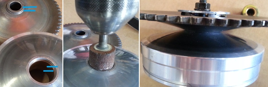

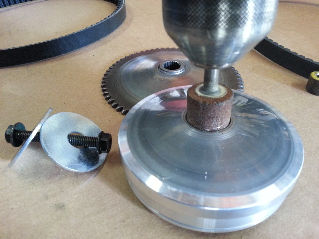

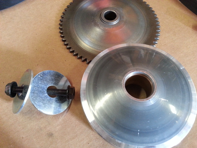

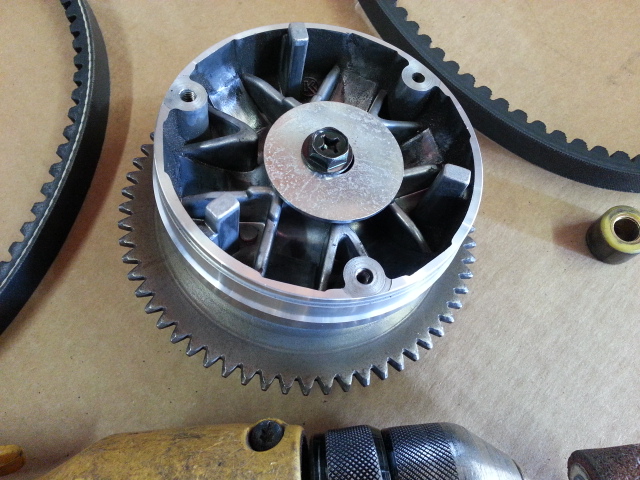

hi forum.
I notice the variator did not close all the way with the fly wheel. so I grind it down a little.
I don't remember where I got it from. maybe steve or fleabay? but it has a K in the inside.
- 20140825_173839[1].jpg (141.21 KiB) Viewed 12727 times
- 20140825_173806[1].jpg (150.65 KiB) Viewed 12727 times
- 20140825_171939[1].jpg (137.72 KiB) Viewed 12727 times

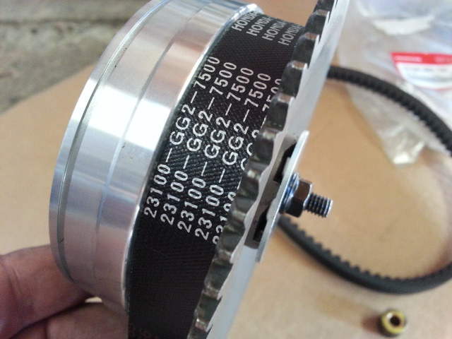

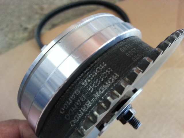

Re: My 94 Elite SR. daily driver. soon to be built.
Now it close all the way.
the new belt looks like it may ride higher.
- 20140825_172730[1].jpg (126.98 KiB) Viewed 12727 times
- old belt
- 20140825_173420[1].jpg (127.74 KiB) Viewed 12727 times
- new belt
- 20140825_173534[1].jpg (138.62 KiB) Viewed 12727 times

Hi G9. I took off very little, it was more like dust.graphite9 wrote:I'd ditch that vari, if you had to grind on it. If it isn't 100% true, your asking for bearing, or crank spline damage. But that's just me.
I did find the package it's a keli variator. I hope didn't damage it?
- 20140826_005307[1].jpg (153.44 KiB) Viewed 12720 times

Looks like its clean up limited to the variator counterbore. Does not appear it would impact running trueness.
thank you guys for all your help.
I was surprised that the Keli variator did not sit all the way.
thanks keith , I wasn"t 100 percent sure on the SR pump.
hi mousewheels. the cleanup was very lite and limited to fit exact.
thanks G9. eventually I will order a new one.
It was strange that i had to clean it out, on a keli part.
I appreciate everyone"s help thank you again.
