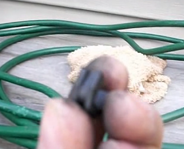

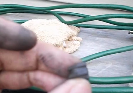

Heres 3 pics. front back side of a chinese slider, its black. no signs of even use on it. there are no unopenned chinese sliders laying around my house that havent been rode on. and the polini. i think 20 miles aftermarket variator use.

Your pictures are confusing. They make no sense. What's the point of it? Looks like you're showing sliders but why. I'm lost.
