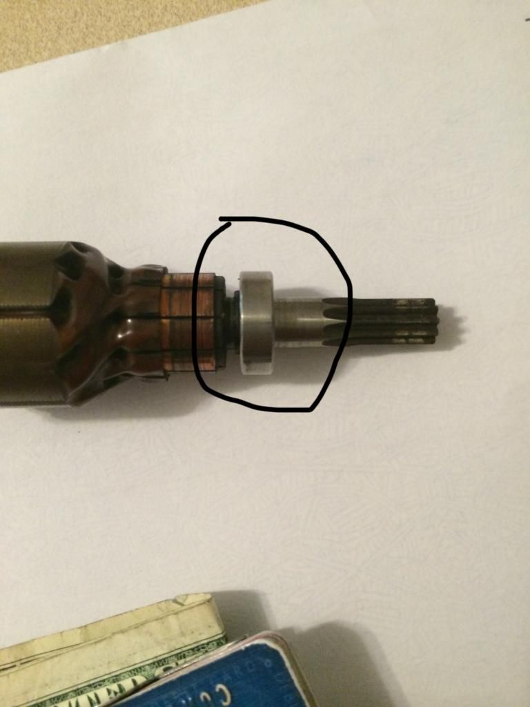

How do I remove this bad boy? Can't really pry at it because I don't want to damage the copper or the arm. So what would you guys suggest? Thanks!

I use a bearing separator and press it off using a hydraulic press. You could try a small gear puller, but if you pull on the outer race, that can cause damage to the bearing. Remember to never side load a bearing when removing or installing.

If it feels bad, pull it with a gear puller. these bearings don't cost much anyway. drive new one back on carefully with pipe (plastic or metal) that only touches inner race.

I'm not reusing the bearing anyway I just need the rear lol. I don't have a gear puller or a press tho but thanks for the advise haven't gotten back to that project since I posted.

curtis966 wrote: I don't have a gear puller or a press tho but thanks for the advise
Then its time to get one! Even a cheap Harbor Fright tool will pull that bearing off without causing damage.
