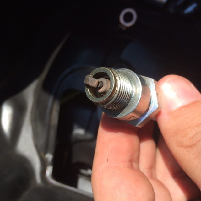

Thanks so much for the help so far everyone. Okay so now I'm running the SR pump as well as 75:1 in the tank. I have it idling fine but am having some troubles tuning the carb. I am running a drilled 91 jet in the stock carb. I am getting a little bit of stuttering when starting out from a stop and also some hesitation/bogging from time to time when I try to accelerate quickly when already rolling at 20-25mph. I am looking to regain a smooth acceleration that I had previously. Any help would be much appreciated!
Do I need to up jet, down jet, punch out second air box tab or just tune the carb better? The plug looks good, I have attached a picture. Also my temps have been good so far as well, the highest temp I have hit it right around 330.

Still rich methinks.

What is your mixture screw set at?

I have been playing around with the air/fuel screw all day but right now it is about 3 3/8 turns out.

That should be too lean.rboarderi wrote:I have been playing around with the air/fuel screw all day but right now it is about 3 3/8 turns out.
Whats it do if you do 1 turn out?

I'll start with one turn out in the morning and let you know!
