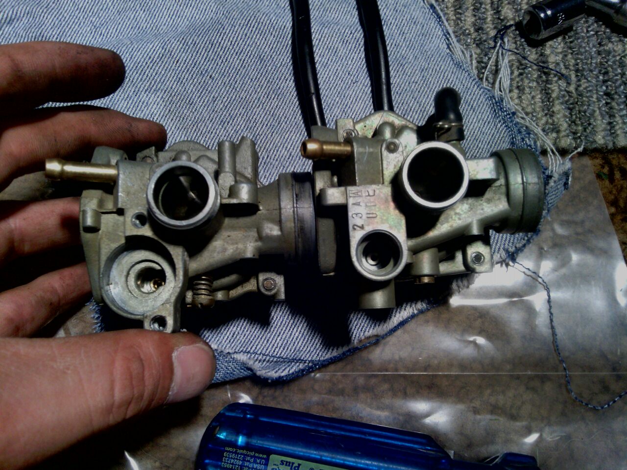

1982 honda sky stock carb and there is no main jet?? Its just a hole with no threads or anything to unscrew. Anyone ever seen this?

That looks identical to a spree carb. Can you take more pictures?

yeah. I had someone on here take a look at it in person and I think he said it was different than a spree carb it was more like an aero or tact I forgot now.

It could be like the express carb and have a fixed main jet, it looks like that

that's what he said it was an express!

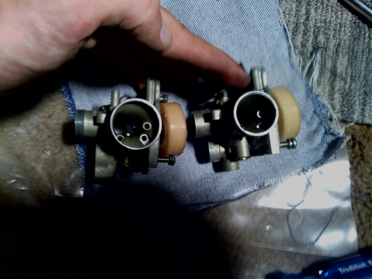

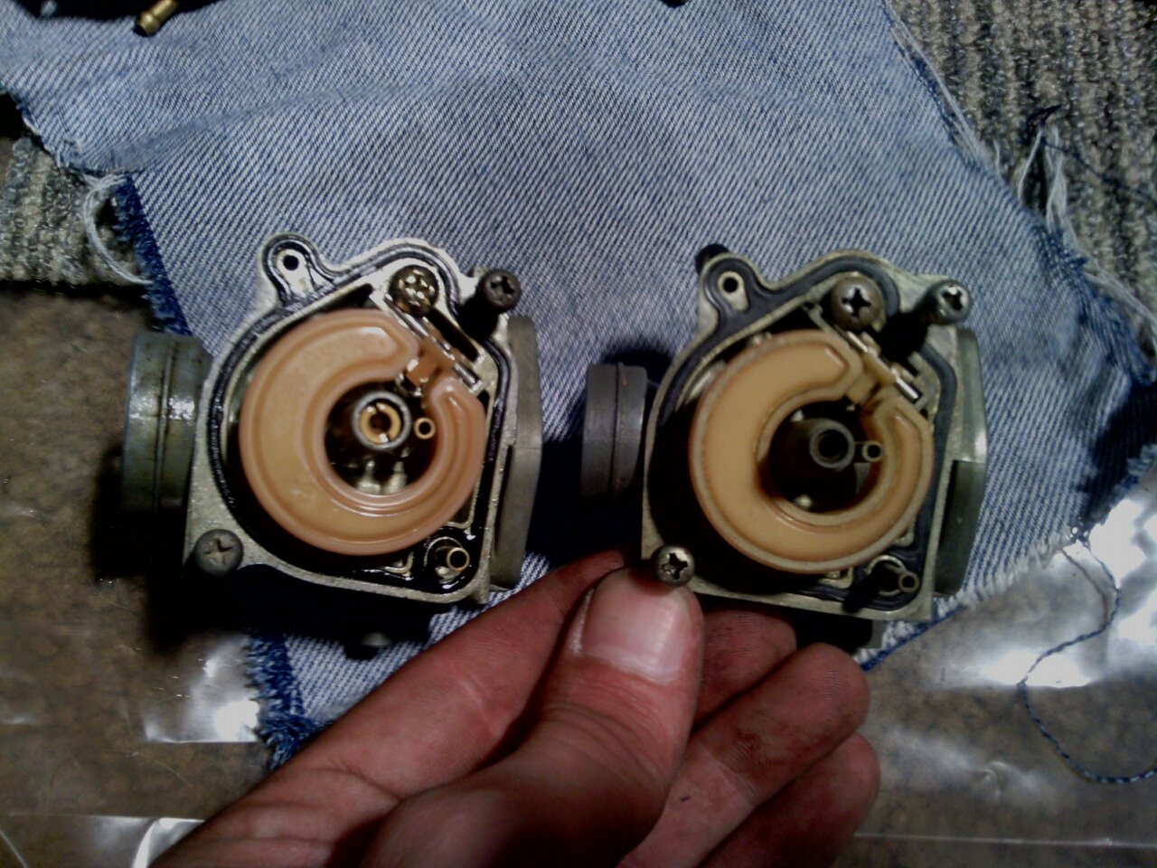

I pulled my spree carb and took side by side pics. the main and I think only differences is the "butt hole" is slightly larger on the spree and one of the needle holes screws on and and on the spree one has a clip that holds it down.

It sure looks like an express carb

Any more pics side on?

Forgot the bolt on side pics but they are exactly the same.

just bolt on that spree carb and do a couple of plug chops to see where its at in the way of jetting

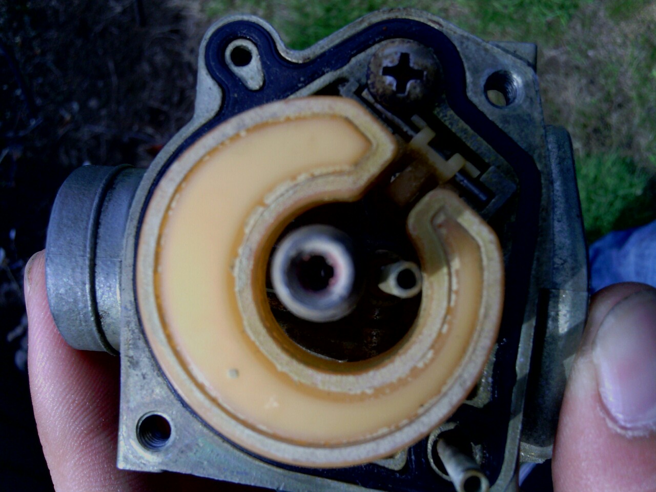

The "needle valve" on the lower left has totally different connections. The sky on the right screws down there the spree just sits in there and has a clip to hold it in. Also the sky has a round thing where the spree has 2 needles. Ill snap pics in the am.
