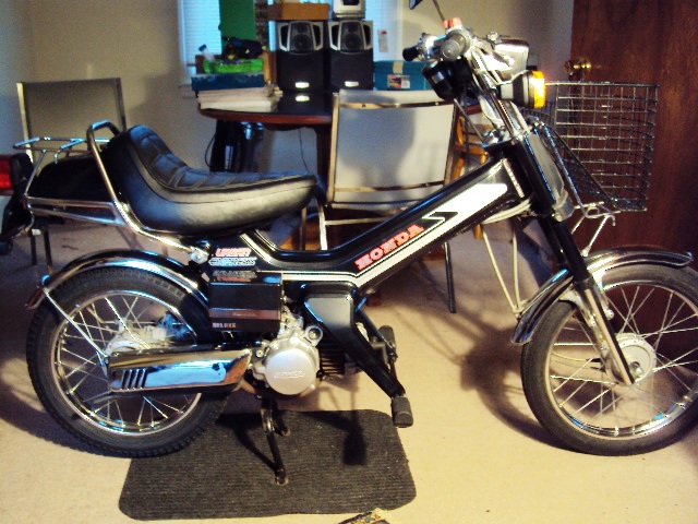

Here's some parting shots of "Keith Urban"
...and one of the NEW whip that awaits me in Georgia... :naughty:
The attachment Urban Express 1-3-14 001.JPG is no longer available
Urban Express 1-3-14 001.JPG (155.01 KiB) Viewed 6426 times
Urban Express 1-3-14 010.JPG (170.65 KiB) Viewed 6426 times
Sym Wolf Classic 150.jpg (82.42 KiB) Viewed 6419 times
