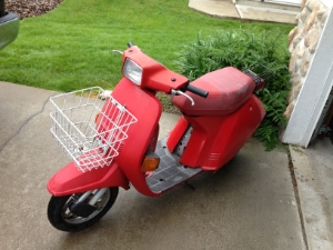

A week ago I purchased what I was told was a running 87 Honda Spree for cheap off CL. I almost made it home when the starting drive gear fell off, uh oh! I brushed it off as "what do you expect stupid for buying a cheap scooter off CL?" I figured I would paint the thing while I tried to figure out what i need to do to get it running.

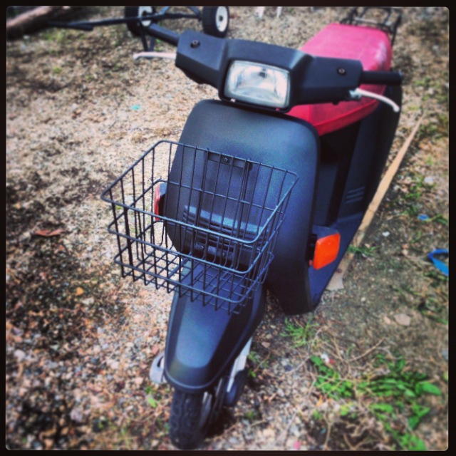

I posted some pics of my super nice paint job and was informed that what I actually bought was a 85 Aero 50 by some helpful forum members.
Tonight I went over to a buddies house and with his help was able to determine that we will probably have to pull the whole engine apart to fix the problem as the starting drive gear took a hunk of the shaft it was welded to off with it.
I don't really want to take the time to part the thing out. I probably don't want to dump a bunch more into taking it to a shop for a rebuild. So that leaves either trying to take it to the welder up the street for a patch job, or just sell the thing and try to get my money back. I really like this little scoot and want to ride it, but may be in over my head.
Any suggestions?

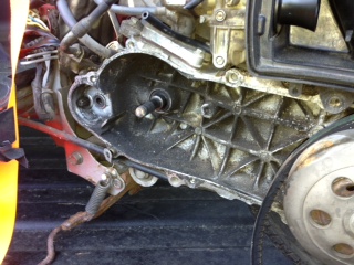

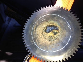

Now that this has turned into a build thread I will start posting some pics. first let's look at what went wrong. Dang ol' gear fell off my scoot while driving it home from where I bought it. Wah waaah!
- photo-4.JPG (50.51 KiB) Viewed 8654 times
- photo-5.JPG (37.62 KiB) Viewed 8654 times

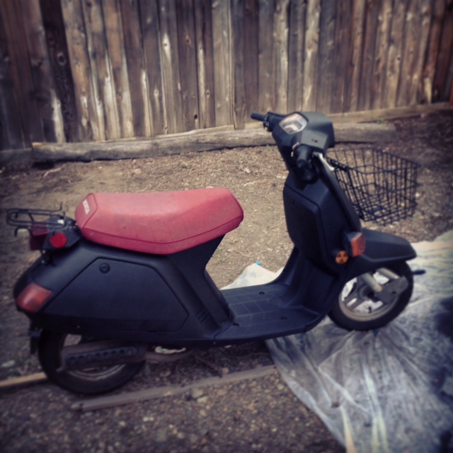

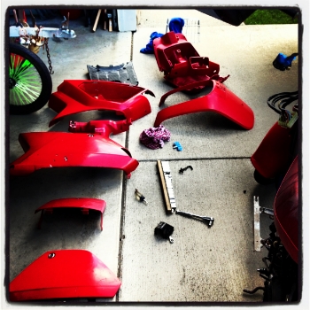

Before photo of scoot and all taken apart to get painted. I primed it with black primer and then flat black. I did a few coats of each. It scratches off really easy so maybe i need to pull it all apart and clear-coat it? I should probably patch up the cracks too while i'm at it. For any noobs out there i recommend using painters tape to hold bolts/washers where they come out of while you paint. it makes it easier to remember where everthing goes.
- b3167a0f-822b-48e0-b827-e11406545e26_zpsc997975a.jpg (118.45 KiB) Viewed 8654 times
- 79893247-d674-47b4-9efd-2eb3ad5aae59_zps08f38b9c.jpg (65.73 KiB) Viewed 8654 times

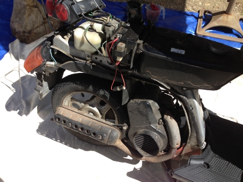

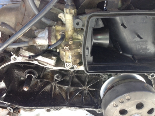

getting ready to pull the motor out, clean and pull her apart. been digging around the forums for a couple hours for ideas.
- 39f18096-c31a-43cb-9390-b42eb67e5ab7_zps2dd0e42a.jpg (147.17 KiB) Viewed 8649 times
- i wonder if these black hoses need to be attached to something? Might be time to invest in a spiffy aftermarket air filter. The dirty rag it came with just ain't that stylish...
- 9d17715d-ee42-439e-881f-cdb22d875192_zpsfb267ff6.jpg (162.21 KiB) Viewed 8649 times

It looks like you have a 4 bolt intake. Which would mean you have an 86-87 aero, or at least an engine from one. I'd rebuild it as well. It has plenty of potential!!! Talk to red eft for a bore kit as well. Worth every penny.

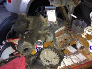

Learning as I go. I have almost no mechanic experience. I have been receiving all my info from what I read from threads on this forum and feedback from members. Today I printed two pages from the 85 Aero 50cc Service manual (41/42) to remove my engine. Few beers later I got her out of there!
- put all my little parts in labeled bags this time to help keep track of them.
- photo-9.JPG (47.81 KiB) Viewed 8624 times

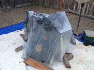

- After pulling the engine I covered the scoot with plastic to keep out dust, pollen and critters.
- photo-10.JPG (39.59 KiB) Viewed 8624 times
