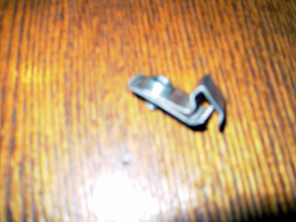

I just finished putting my 1986 Honda NQ50 Spree back together and have two clips left over. CanÔÇÖt find where they go in the manual. Can someone help on where these clips in the picture go?

I'd have to look at my spree, I don't recognize those. Maybe one of the guys that have torn their sprees down to bare frame will recognize them if they are part of a spree. To me they don't look like they belong.

I don't recognize those ether but i wood guess that some one put then on to hold the cable on the frame .. it not stock ..

Those clips are used to hold the "glove box" to the front leg shield. The 86 did not come with a "glove box" but honda did offer it as a add on option.

probably a good "extra" spree part to have ....
gloveboxes are desirable up there with petcock covers & baskets & kickstarts....
