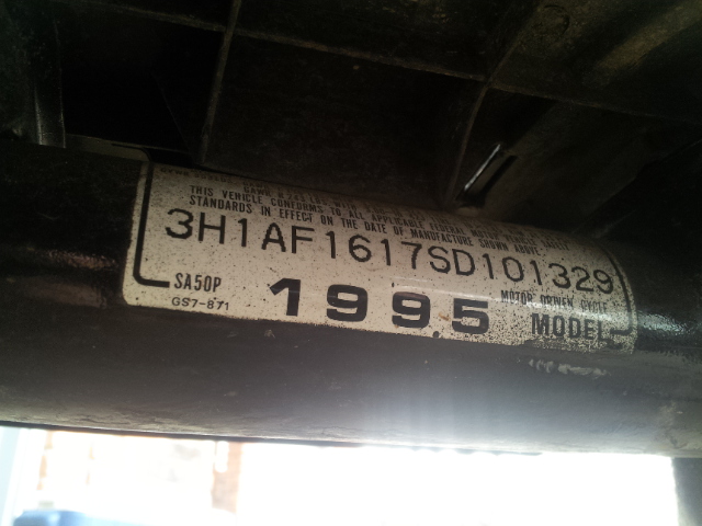

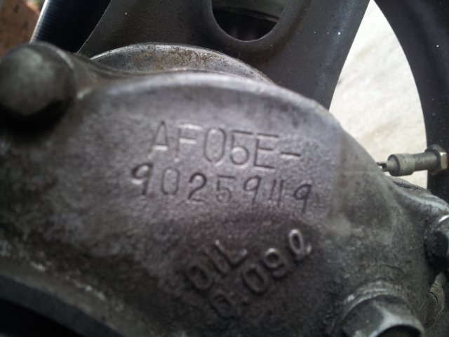

So this is my first scooter and im a bit confused to what i have it is a 95 Honda elite duh lol but the vin says it has the af16 right ???but the back of the motor says af05e... like i said this is my first scoot and its tons of fun but don't want to order parts that don't fit so any help would be greatly appreciated

You dont have an AF16 thats for sure.

Being that the af16 gear ratio output is 12:1 which is ridiculously low, and from my understanding, it is possible to swap the gears out of an af05 if you use all the gears and the cover.
This should bring up the output gear ratio to 11:1.

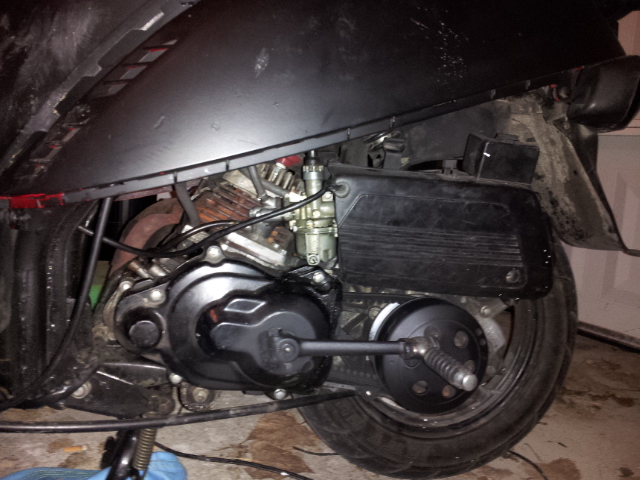

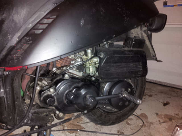

ss421, could you give us a pic of the entire motor?
I do have an af16 with an se50 gear cover and gear set that works just fine.

ss421 wrote:Then its a variated af05e than???
Judging by your pics I'd say yes. From an NB50 Aero?

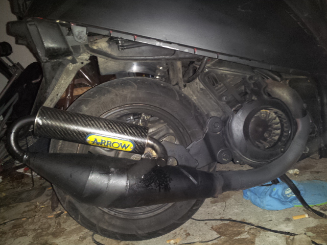

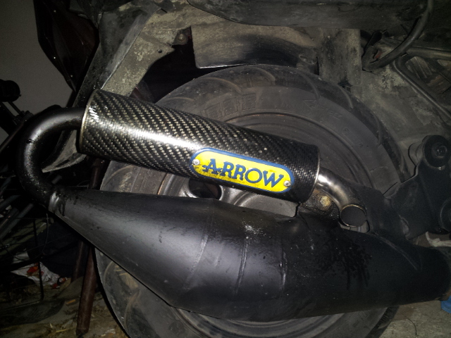

Shoot some pics of the arrow pipe. Thanks.

Thats an AF16 kick cover, af16 fan shroud on the pipe side that has been taken apart, the AF05 cover doesnt come apart like that, arrow hasnt made a pipe for the af05e for a long time if you do have one its worth a lot, one more thing that pipe is angled coming out the exhaust port in the direction the AF16 angles not the af05s.
