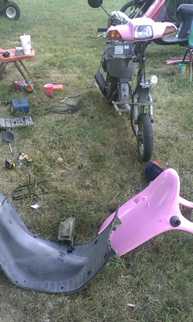

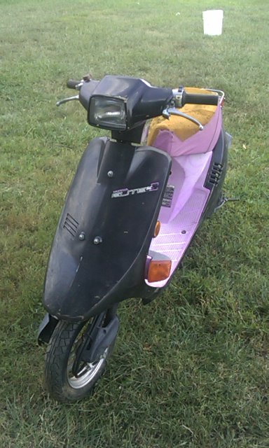

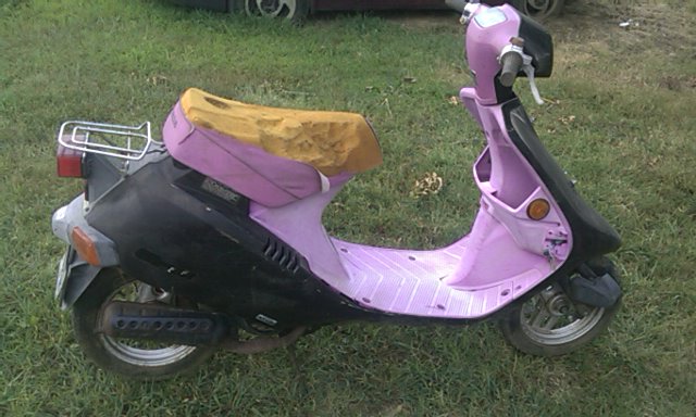

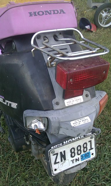

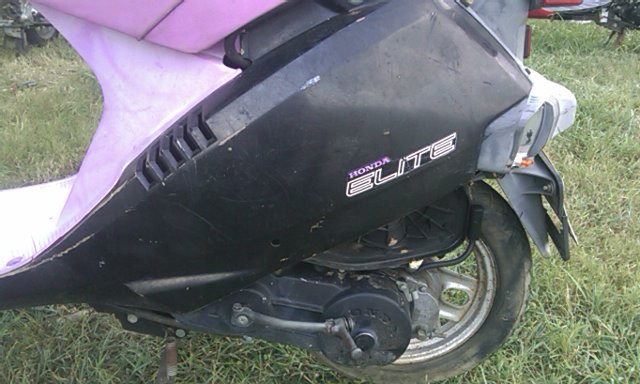

A few picsof the se50 when I brought it home. Will take some pics tomorrow of my progress
I havent been taking as many pictures of my builds lately cause after a while it all looks the same
lol before and afters is what I will mostly be doing unless I am doing some major kewl looking upgrades or something

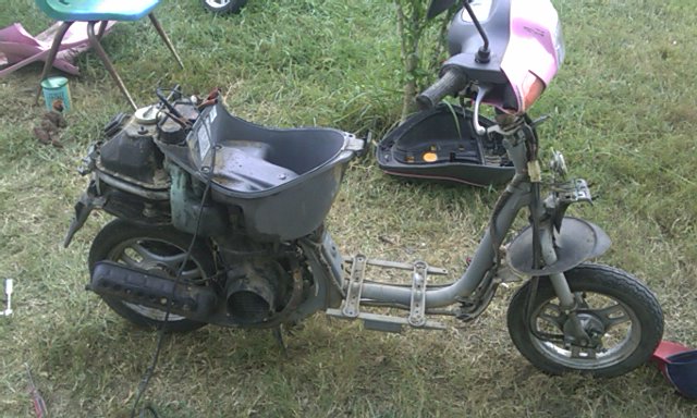

only 4 pics of the se50 so here is 2 of the 89 sb50p i got with it that my sister has claimed. didnt get a pic of it off the truck, as soon as it hit the ground she was taking the plastics off to clean it up lol my mom seems to think the se50 is hers O.o

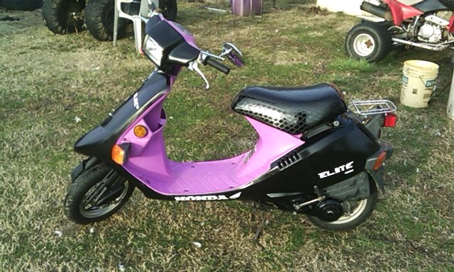

just bumping this up gonna post some pics as soon as i figure how to transfer from my phone to tablet. mostly finished need to make decals and snag a turn signal
---wanted to get all the before and after pics on the same page hahha

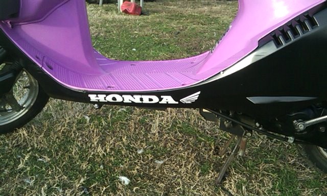

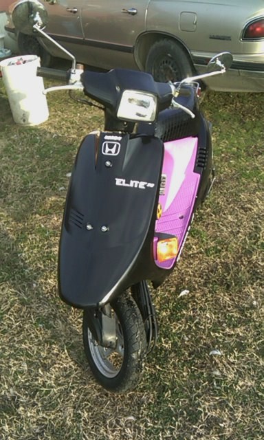

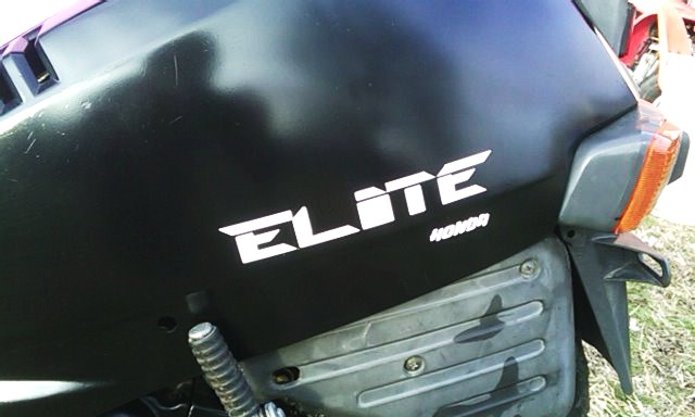

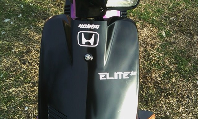

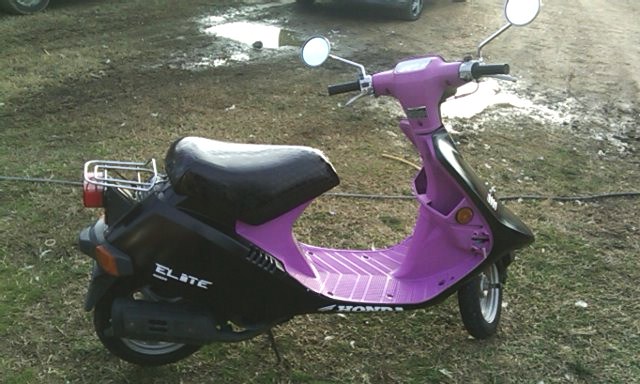

....finally got her finished up for the most part just need that pesky right front turn signal and I wanna paint the rims the same color as the purple floorboard etc What ya think of my decals I made

An enviable scooter nicely done. Good stickers too, but Honda-san may not approve of the graphics... Then again, he doesn't own it.
