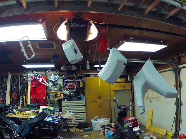

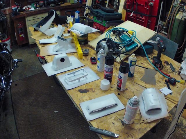

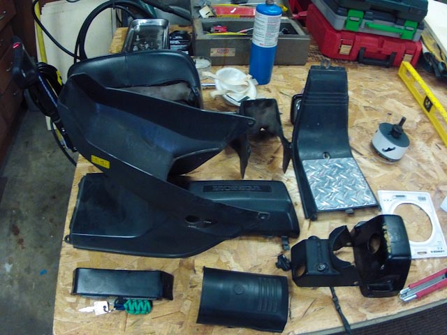

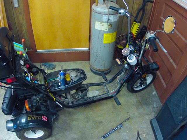

Just a little documentation of the process I'm going through to repaint my gyro. i figured this would be a good learning experience for me to help with perfecting my painting skills. any advice or opinions are welcome. :happy:
the bike almost stripped of the plastic panels
before the parts were sanded down

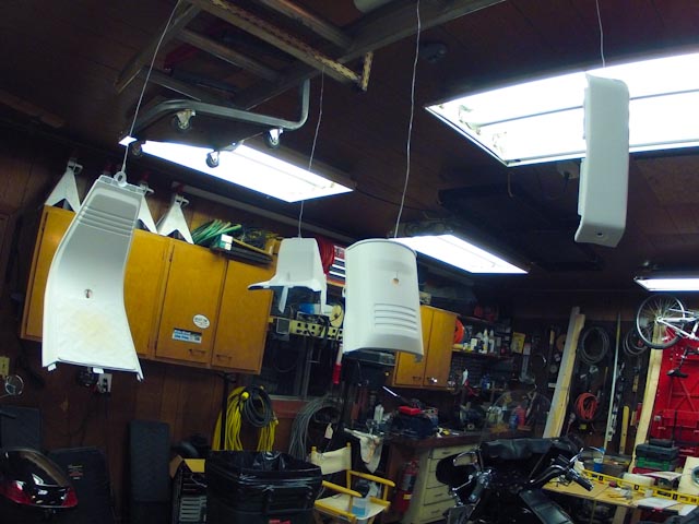

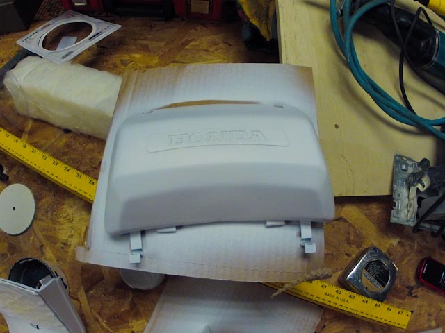

done with first coat of primer. Im letting them sit for a couple days then ill start sanding.
Sorry for the mess. Been busy doing some remodeling.

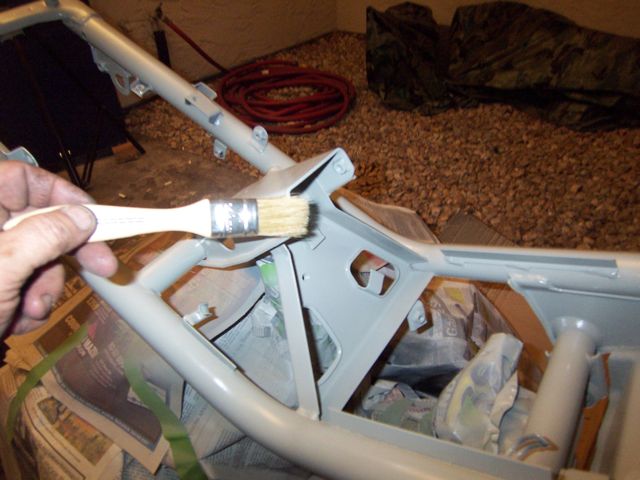

Re: Honda gyro repainting

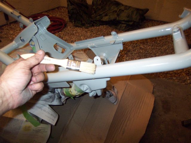

I kinda like the gray industrial look ....
And I actually painted a Gyro that color .
I tried to get in all the tight spots .
After the paint dried .

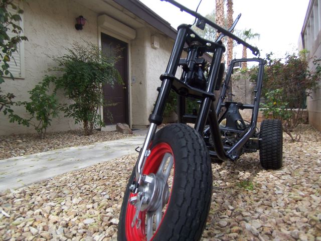

I tried to also do a black one.
I didn't remove the forks because trying to pick up 27 ball bearings
really sucks .
A few pages of Sundays paper /some tape/cover the engine with some plastic sheet/ start painting ...
Let it sit in the sun for a few min. Done !

done with the second coat of primer. I'll start prep for the first base coat tomorrow.

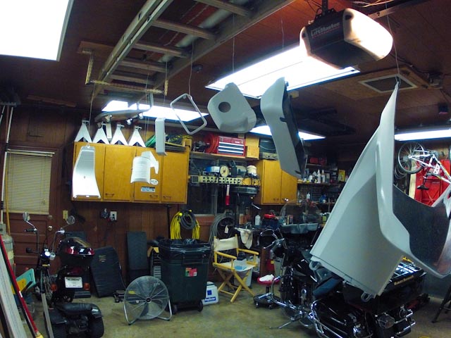

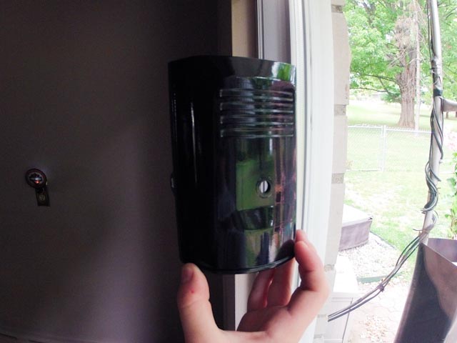

Done with the first base coat. They came out AMAZING. I'm really impressed with this paint. first coat with no sanding or polishing and its almost a mirror finish. Probably going to start sanding today then lay down the second coat. after that its on to clear coat. i know clear over gloss paint is kinda redundant but I'm doing it mainly for scratch protection.

my process has been sanding everything down with 220 grit wet dry. painting with 2 coats of primer sanding between each coat. then painting 1 coat of black and sanding that with 3000 grit wet. then the final coat of black and two coats of clear. Alot of work but its all worth it.
