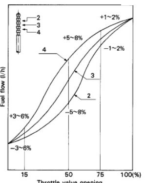

Lowering the clip should be richer in the area of needle influence (see diagram)
With the needle lifted - maybe your engine is 'four-stroking'? I've had scooters alternate between normal and four-stroking. Weee..neee..Weeee..neee all the way home :D . http://en.wikipedia.org/wiki/Four-stroking

mousewheels wrote:Lowering the clip should be richer in the area of needle influence (see diagram)
Thanks Mouse, I will return the needle to the previous clipped position and see if the issue resolves.
