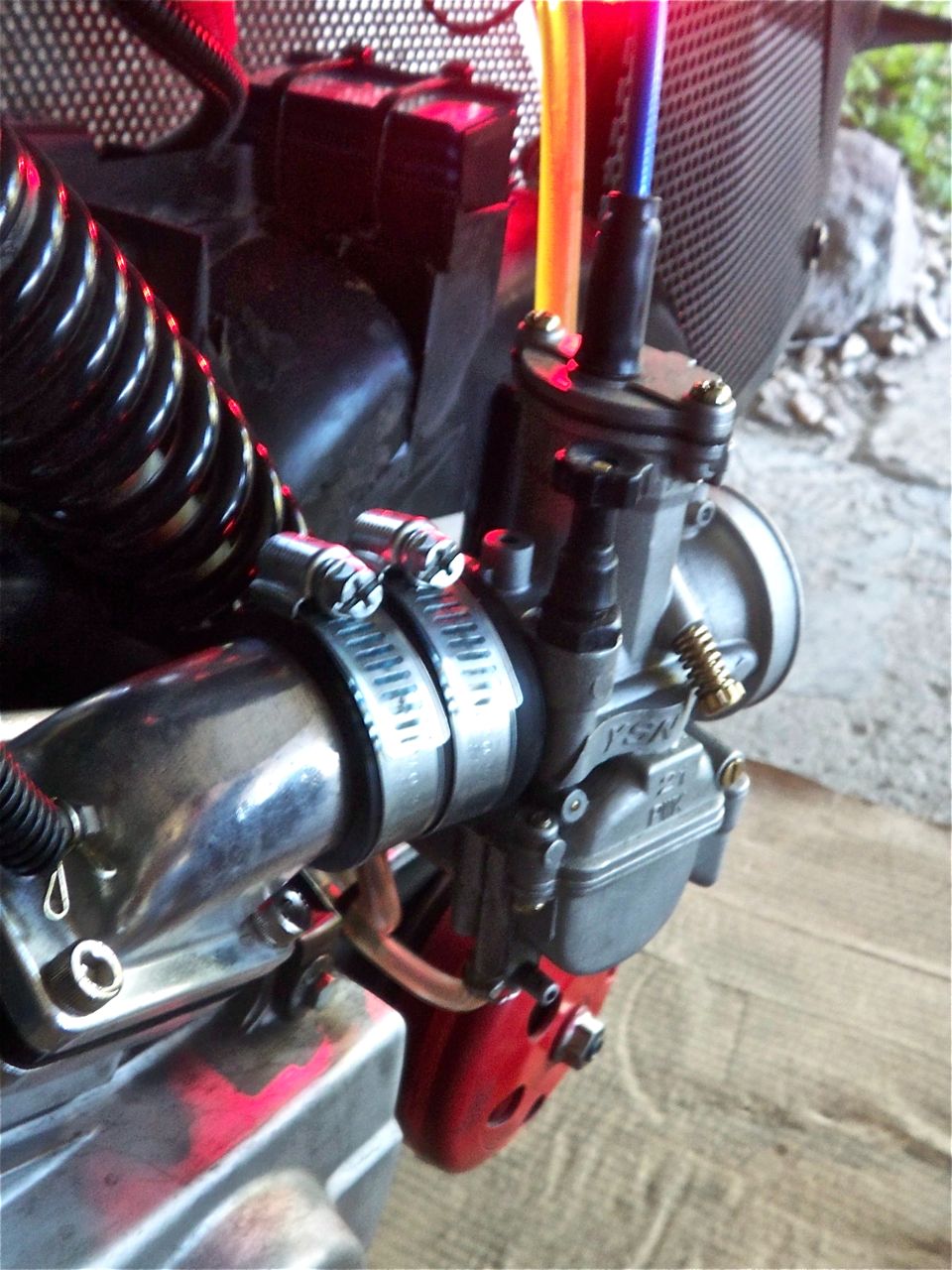

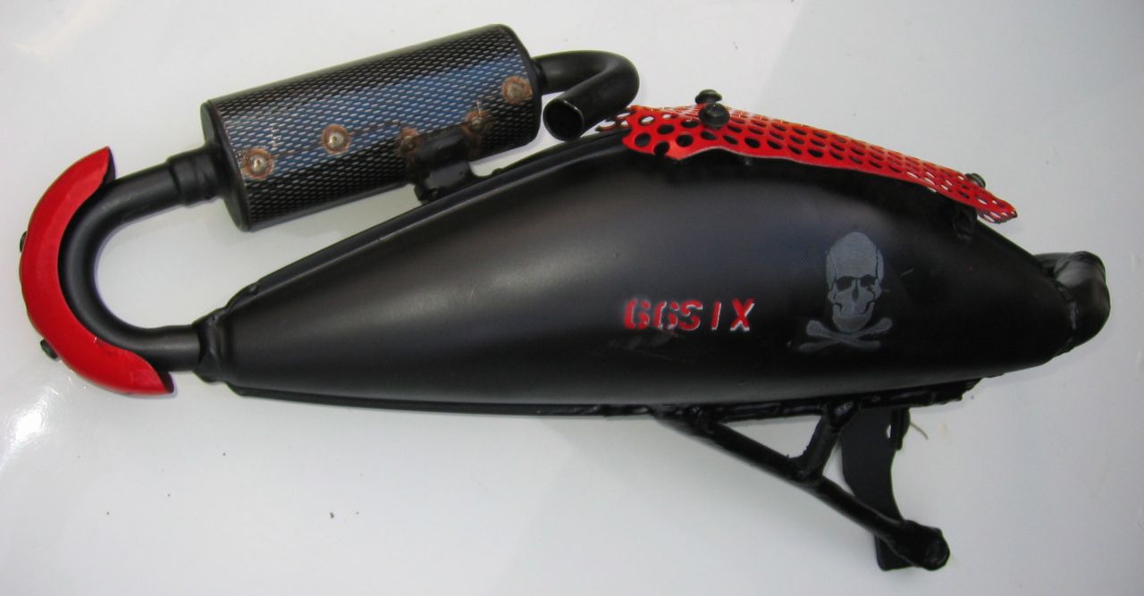

I have the Tazz kit and re-did an old pipe
My little spree is a blast to ride
and the extra power is noticeable but don't think you will be popping wheelies .
Well small ones maybe ?
