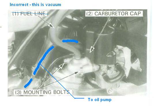

Re: Not enough vacuum
Steve,
On an Elite SB50 and Elite SA50's, the carb fitting is where the oil is injected.
On Spree's, there were two taps on the intake, the upstream tap was for vacuum, downstream for oil injection. On the SB50, Honda changed the intake to only the vacuum fitting. Then added the fitting for oil injection to the carb.
Your scooter has oil injection connected to the intake manifold, and the vacuum line to the carb. It is reversed from the factory connection.
-- Here is a photo from the Honda SB50 Service Manual.
Honda labeled the line from the intake to petcock incorrectly. It's a good enough photo to demonstrate this line does not route to the oil pump. The blue marked line I believe will route from the carb fitting to the oil pump
- SB50_Petcock_Connection.JPG (26.78 KiB) Viewed 10250 times
The fitting for the petcock vacuum source is always on the intake manifold, NEVER on the carb. The nipple on the slide bore is for the oil injection pump output.steve beddow wrote:I checked the vacuum directly at the nipple where the petcock vacuum tube is connected. Absolutely no guage movement. THis nipple is located at the throttle slide position. Any way I used a t fitting on another vacuun nipple and all works well.
