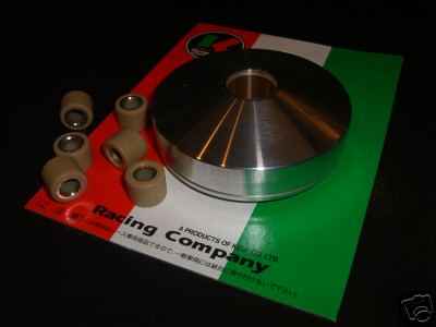

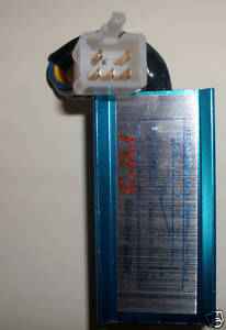

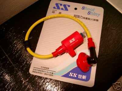

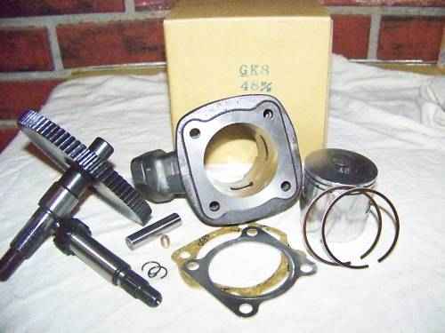

ive got a spree bilt to the max cant get it fired up wants to fire but wont will u help me out ive got a 48mm bbk onit diff trans gears diff clutches performance exaust i have it jetted ive got a racing cdi box on it and a racing coil and thats pretty much it i think my stater is bad but not sure i had the head shaved had the intake bored and thats it i think ive got about 600 in to it and bought it for 140 dont know how fast it gose yet cant wait to find out but i think the stater is bad
thats before i bilt it

more parts i added

:*: is it just me or does honderman spree pic look familiar?, scroll down and look at the bottom banner. huh? and why would you buy a variator for a spree? :crazy:

odinxxix wrote::*: is it just me or does honderman spree pic look familiar?, scroll down and look at the bottom banner. huh? and why would you buy a variator for a spree? :crazy:
Agreed, looks very familiar. Boy hope daywot gave him instructions on how to install that Keli!
