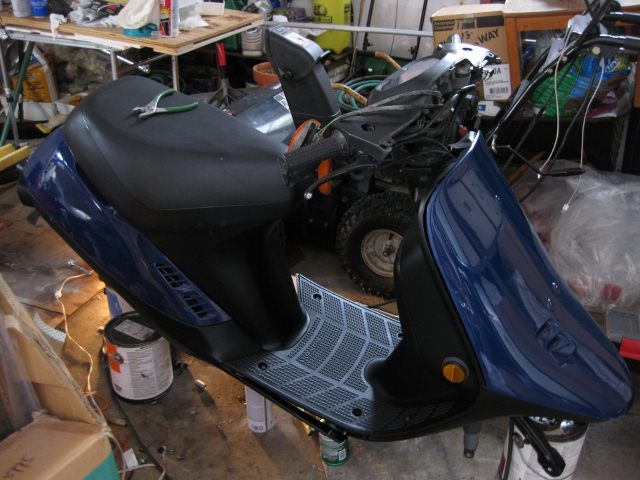

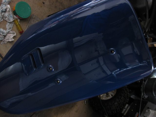

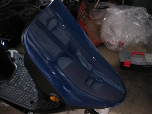

some more updates
IMG_0186 (640x480).jpg (85.87 KiB) Viewed 5054 times
IMG_0184 (640x480).jpg (58.89 KiB) Viewed 5054 times
IMG_0172 (640x480).jpg (59.76 KiB) Viewed 5054 times
dun rite
Posts: 662
Location: Naalehu, Hi
Re: Thanks to all who help me out !!!
Post by dun rite »
I like that blue :smile: Nice reflections on the paint, looks awesome

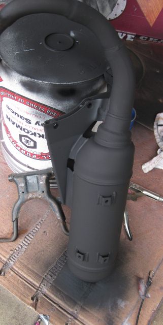

Flat black vht paint
IMG_0212 (321x640).jpg (62.62 KiB) Viewed 5047 times

dun rite wrote:I like that blue :smile: Nice reflections on the paint, looks awesome
thanks it is a from duplicolor . I was going for a night blue but couldn't find it at the local auto parts by me . So i choose the royal blue
