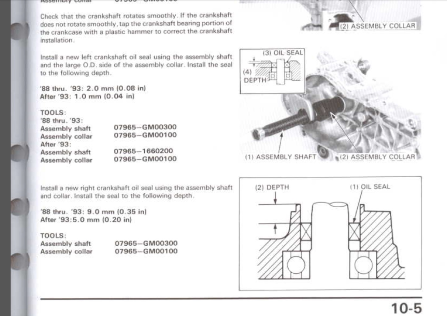

section 10 page 5 of shop manual
Re: My first elite build
Posted: Fri Nov 15, 2013 8:54 pm
by bfowler
Saw that in the manual but I'm not too sure how to read those images. But I guess 0.2 inches from the opening?

Well posted in the technical help about my gear cover issues that I'm experiencing. As a side issue, I'm pretty sure I installed my crank seals backwards. I hope they'll still do their job. Maybe I should put some honda bond around it?
Posted: Wed Nov 20, 2013 5:04 am
by bonesv
bfowler wrote:Well posted in the technical help about my gear cover issues that I'm experiencing. As a side issue, I'm pretty sure I installed my crank seals backwards. I hope they'll still do their job. Maybe I should put some honda bond around it?
What??? Do not run them if they are in backward. They will most likely leak. Hondabond will not work, don't even try. You can get them out and replace them easily. Post a pic of the seals installed, someone will tell you if they are in correctly.
