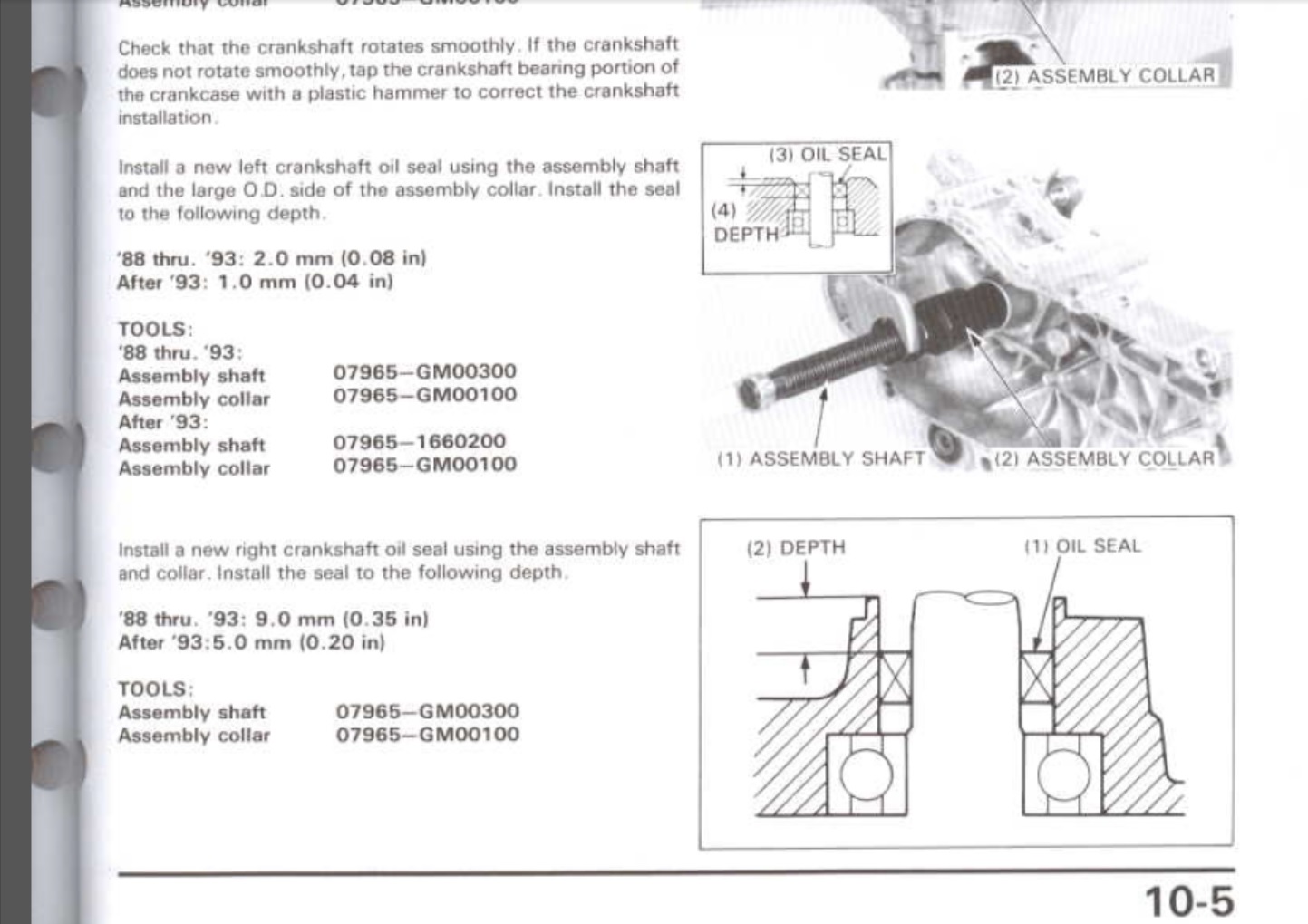

Post by cruzingratiot »
section 10 page 5 of shop manual

Post by bfowler »
Saw that in the manual but I'm not too sure how to read those images. But I guess 0.2 inches from the opening?
