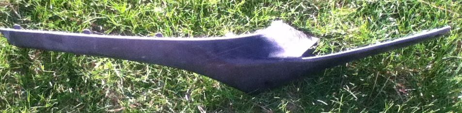

Like THis kind of plastic what is the best way to paint them? What I don't want is for them to look to glossy. i want to paint it and make look like like the way it was before. What is the best paint for it . I also don't want to used bed liner on them . I am going to paint them all black and the body a night blue or a sport red . I haven't decide yet .Peaceeeeeee

if you don't want it shiny then use a flat black or satin. but painting on the floor boards will come off after some use.

Thank you I guest I am ready to paint now . I am trying to find Urethane Supply Company's hardset epoxy filler . I had repair some crack with fiberglass repair but don't know what type of epoxy filler to buy. I think it is a gray color thing and then need to sand down when dry . Dun Rite thanks allot for helping peace to you .

here's a plastic repair topic in the wiki http://hondaspree.net/wiki/index.php5?t ... tic_Repair

Happy for your progress. Good luck with the paint job, on my last build,
I used a flex bumper and trim paint with adhesion promoter primer. Not glossy.
I might try a matte clear coat to give it some protection.
