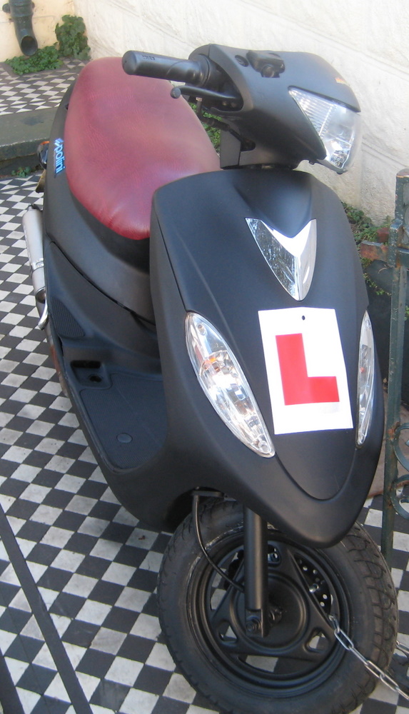

scooter
- heres a picture of my scooter after i sprayed the whole thing matt black

Re: Sym dd w/ hona dio engine i need help please!
Wow, I feel SAD for that chain lock....
