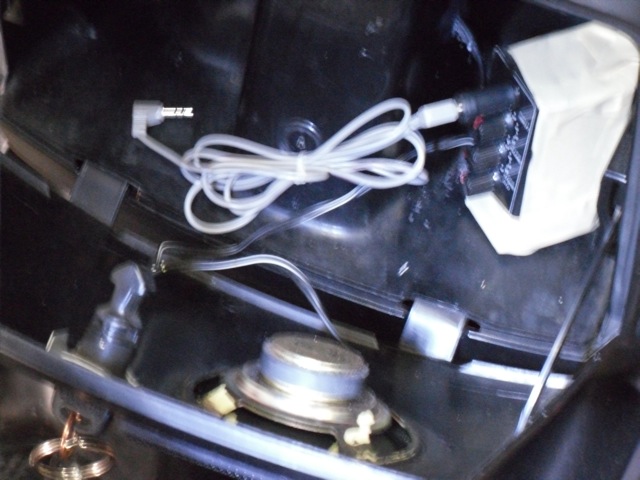

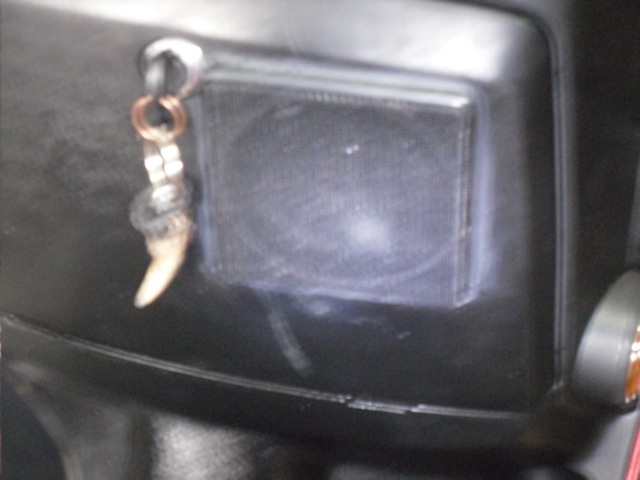

heres what i was up to today: took apart the amp and glued it into glove box, is way better than having it on the rack
- SAM_0653.jpg (63.33 KiB) Viewed 4603 times
- SAM_0652_2.jpg (85.77 KiB) Viewed 4603 times
