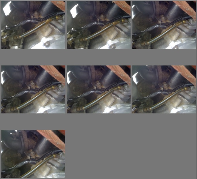

One thing I was a little paranoid about was if the oil pump was working. I had taken it out to clean it when I first started this project and it looked good. For these first few starts I have used a light premix because I was not 100% sure the pump was doing its thing and did not want to be screwed! When I put the carb back on on Tuesday I put a little air in the oil line(first shot top right of the hose you can see the difference in color where the bubble is) to watch if the bubble would be pushed out by the pump, check out the photo series, it speaks for it's self.
