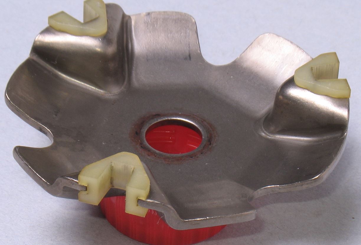

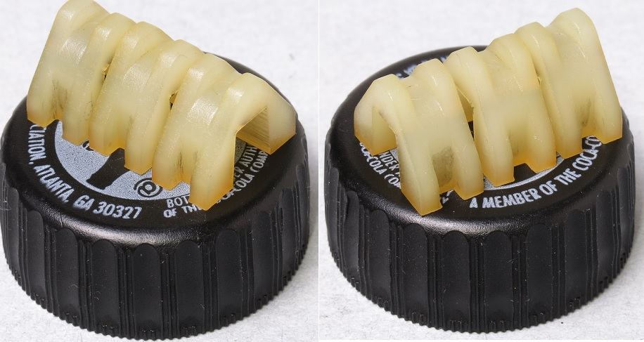

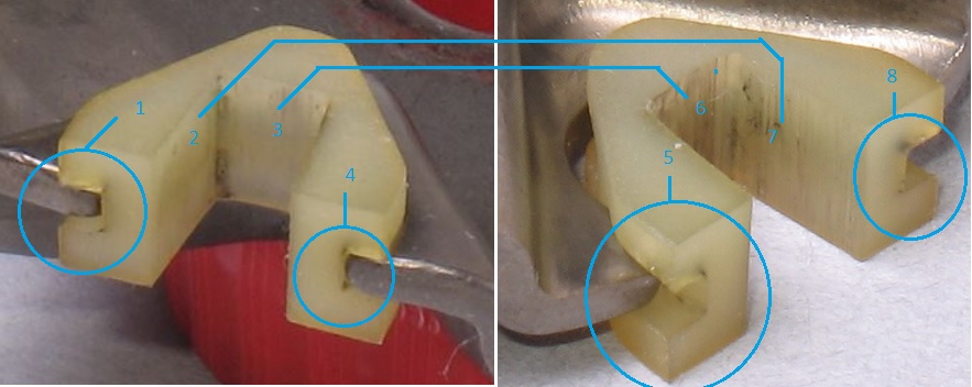

Here's OEM parts at ~3k miles:bajack wrote:I sure could use some pictures of someones slide guides about right now..

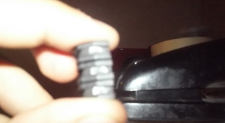

the outer part. im not having a ring getting dug in on the back now, and i dont have to use the stock ramp plate. but i am using the stock variator with the same results. i need to use this other stock type i got on ebay, looks the same just doesnt have metts and stuff wrote on it, i thought maybe it might of had problems is why i never tested it.
the outside of that slide guide, where it touches the ramp.
heres the first set i noticed.
- thispic.jpg (133.08 KiB) Viewed 7619 times

I do not see enough detail of the failure from your pics to comment, yet post opinion, and pics in case it is helpful.bajack wrote:the outer part. im not having a ring getting dug in on the back now, and i dont have to use the stock ramp plate. but i am using the stock variator with the same results. i need to use this other stock type i got on ebay, looks the same just doesnt have metts and stuff wrote on it, i thought maybe it might of had problems is why i never tested it.
-- Arm chair troubleshooting
IMHO, Honda designed the Variator/ramp plate and guides such that worst case, there is no bind between the ramp plate to guide seat and the variator splines the guides ride on. Centrifugal force will force the guides outwards. Thus they should only wear on the variator side, with design tolerance giving an air gap on the inner side of the guides.
Possible sources of Damage to the guides inner surface:
- Worn hole dia in the ramp plate
- Wear or excess slop in the variator bore -> variator bushing wear.
- Undersized or worn spacer which the variator rides upon on the crankshaft
- Worn crankshaft dia in the area of the ramp plate interface
I looked for inner guide surface wear, yet see *zero* wear on the posted 3k miles parts.

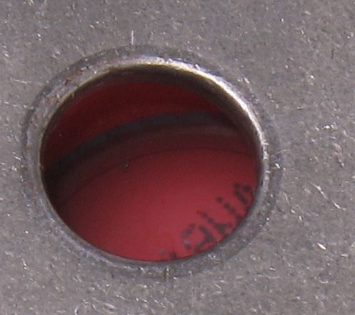

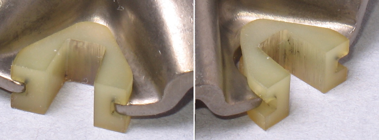

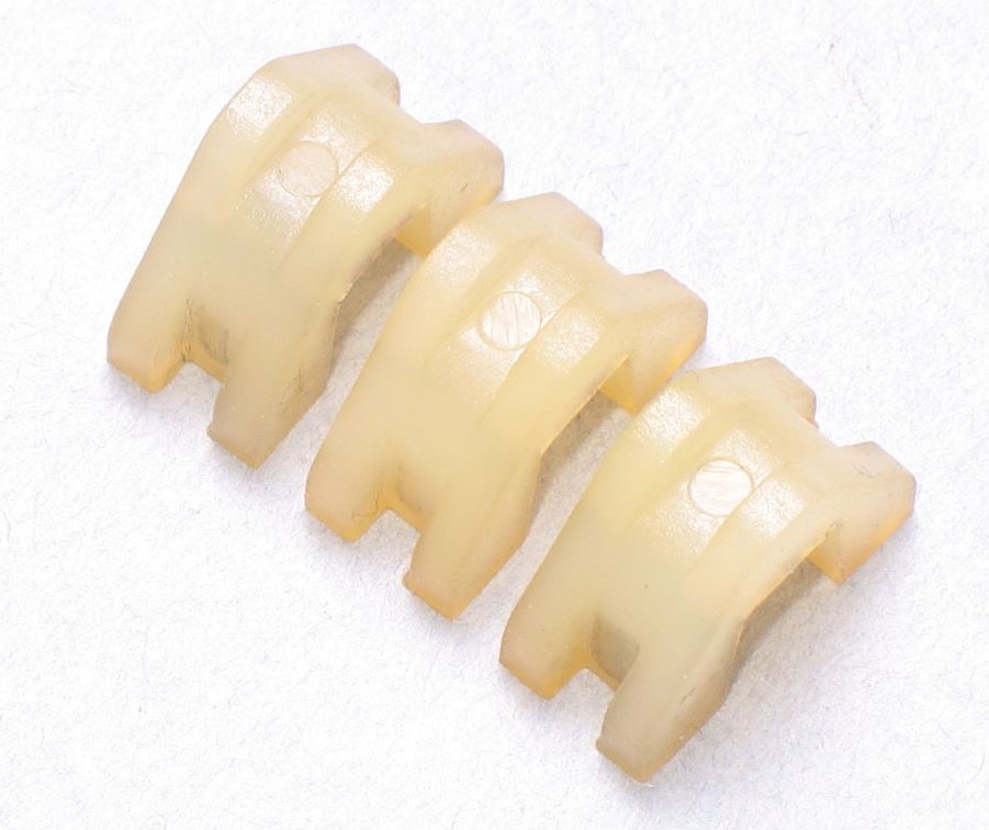

Oh, I thought you wanted the inside edge, because the first set of pics showed little wear at points labeled 1,4,5,8. Here's a pic of each side. There's not much wear on the plate/guide surfacesbajack wrote:is that both sides? looks like that? this was only happenning on one side of my guides.
