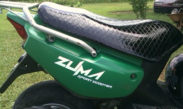

Here is a pic of the decals i made for my zuma today
