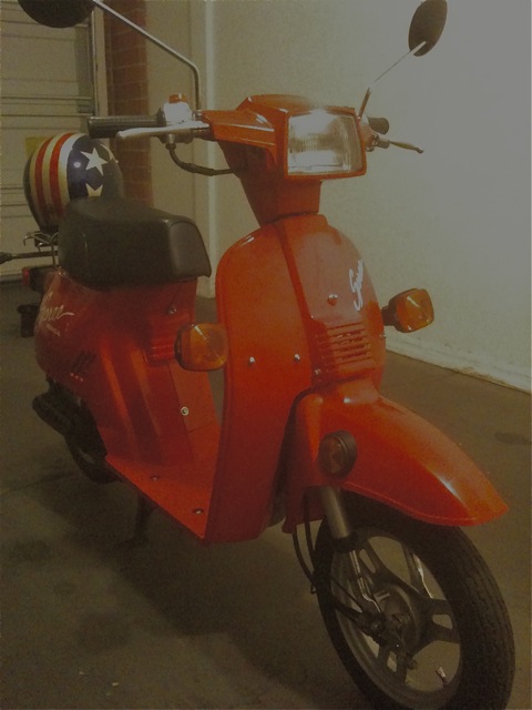

Attached is a crappy shot of my now-running-great Spree. 850 original miles, perfect shape, all original - $250 bucks! All it took was a cylinder draining, a petcock soaking, a carb clean, a new spark plug, and a new battery

Dang, Dude! They just don't get much purtier'n that one. Nice score, particularly at that price!
Glad you got it running well.
