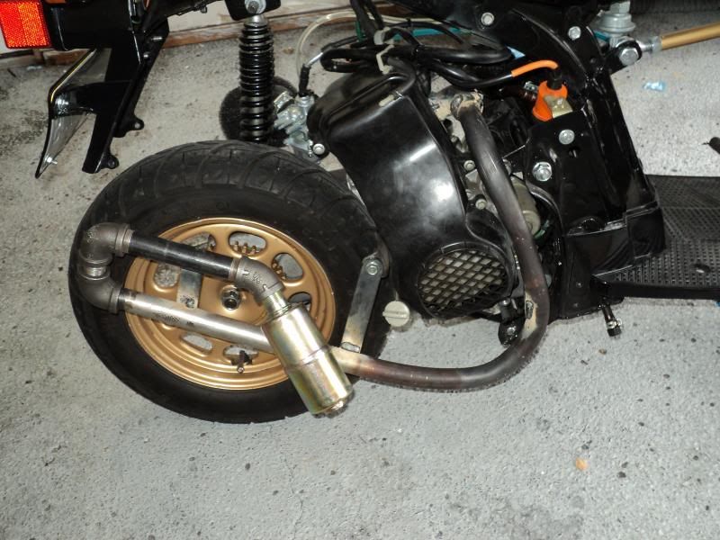

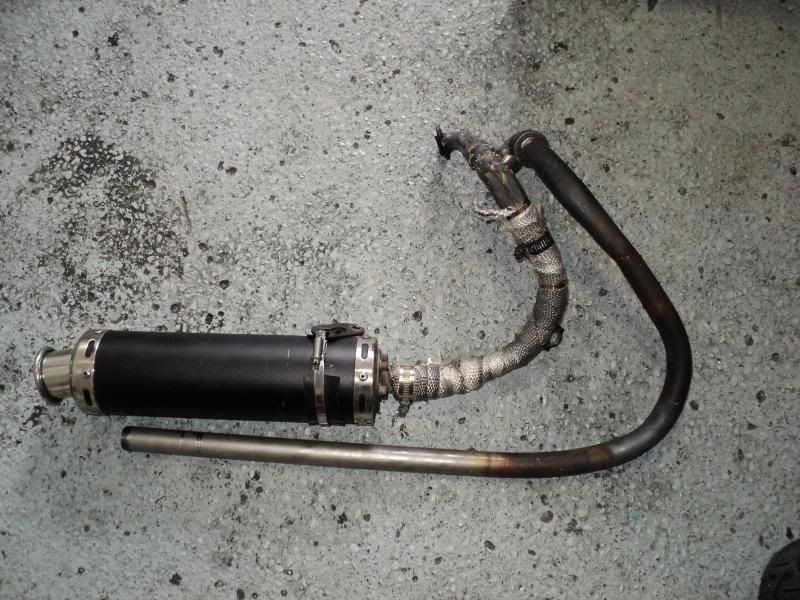

I made my own header for the ch80, it's slightly larger diameter than a stock pipe. It's not perfect but should perform better than the stock pipe that's been cut and welded. The bends aren't perfect, but not bad for my first time.
The exhaust port/flange on the ch80 engine is actually the same size as a nq50. I had a old spree exhaust that was all ready cut up so I used the flange. Still need to make mounting brackets but it should work out well.

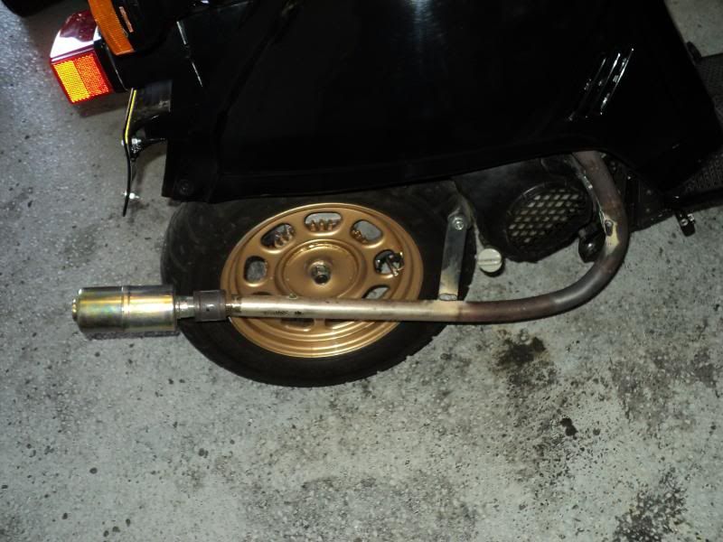

Trying out a $6 briggs and stratton style muffler, but I'm planning on buying a nice exhaust pipe sometime over the winter. I used some fittings to make it loop around but ended up just making is straight. It's loud but it performs a lot better and I'm now getting up to 50mph.

That seems like a good option for the ch80, but I can't find a cheap knockoff Yoshi anywhere online. I've only found the real deal yoshimura for $200-300+, which I can't afford.
I have been thinking about a FMF powercore 4, they're around $150. But it's a well known muffler for off-road dirt bike use, some cop might see it and try to bust me. I guess I could just peel the sticker off... :lol:

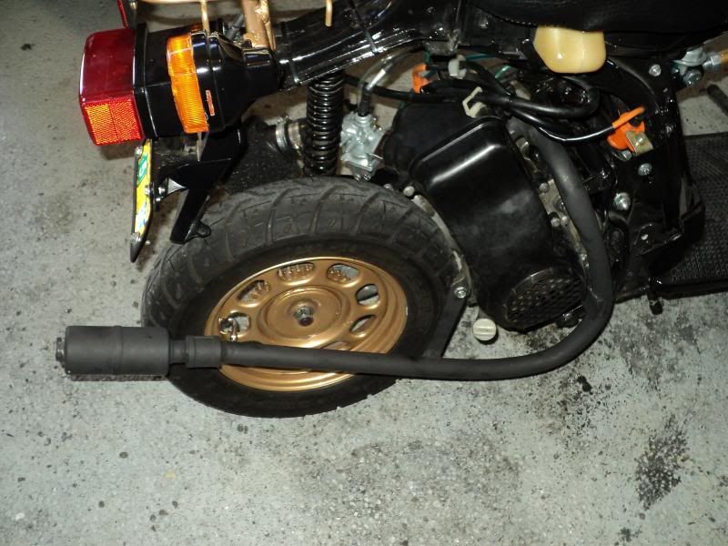

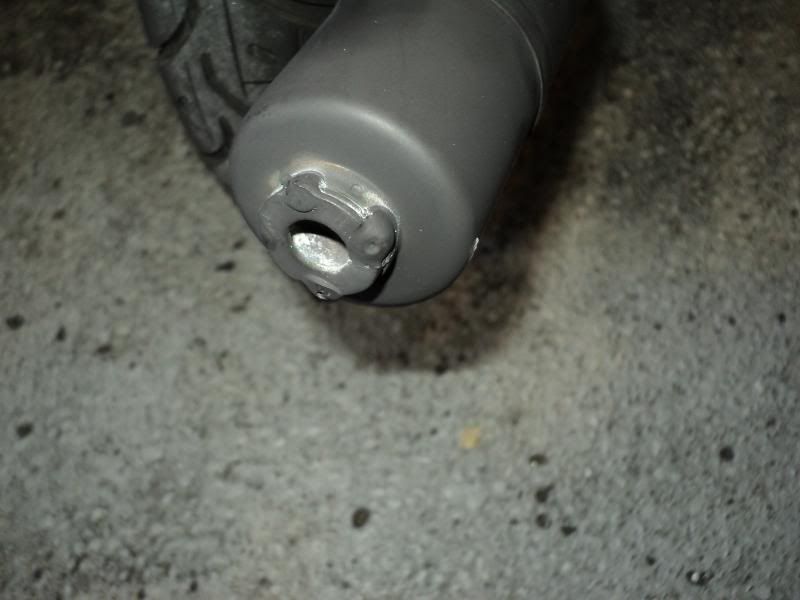

I painted the pipe for now, also welded a washer to the end of the briggs muffler to quiet it down a bit.

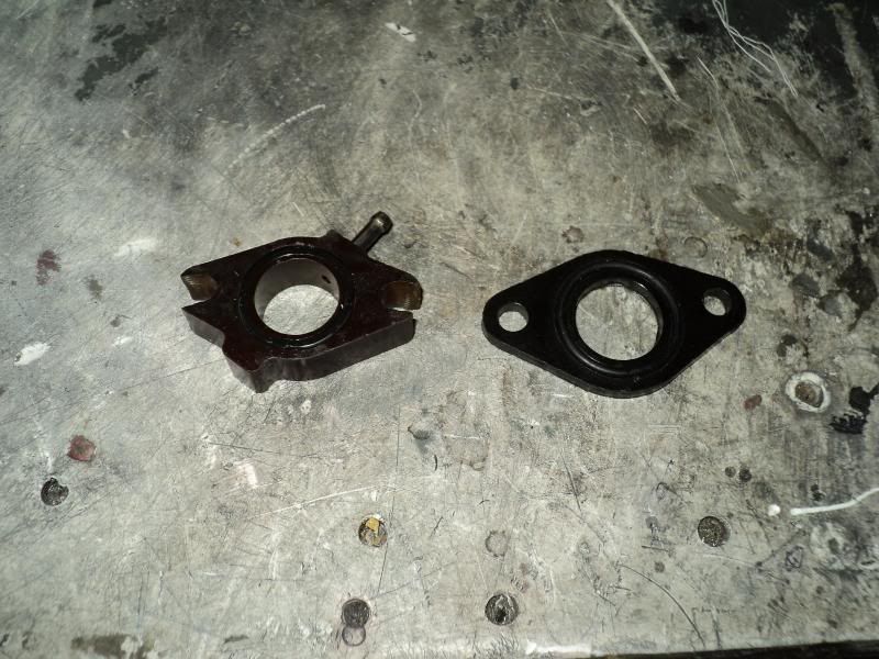

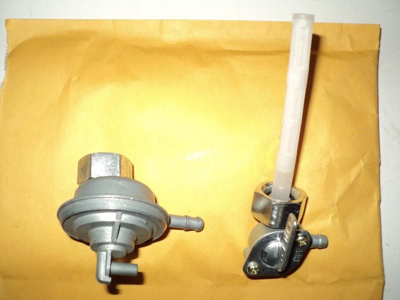

I switch to a manual petcock fuel valve and changed the ch80 isolator with the vacuum port to a regular isolator for the PZ19 carb.

d*** where did you get that manuel fuel valve? Did it bolt right up or did you have to cut and weld? I need to do that for my Honda Spree Eve Smile. The JApan Smile gas Tank uses a manuel fuel valve instrad of the american regular petcock. So when you run the Eve Smile pannels you need to run the Eve Smile gas tank other wise the petcock doesnt fit where the Fuel valve hole is on the smile pannels and you have to cut the pannels.
But i dont want to have to cut the pannels so If i where to find a Fuel Valve just like the one you have I think it would work. Im trying to build another Red Eve Smile on top of the black Smile that I already have but Its super hard to bring a Gas tank from japan into Hawaii, For some reason customs are pricks about it
Tyler VR
Posts: 582
Joined: Tue Sep 27, 2011 12:38 pm
Location: Portland, OR
Re: Spree Engine Swap: Honda Elite CH80 onto Spree
Post by Tyler VR »
I bought the fuel valve off ebay, screws into the stock tank without modification. Finding the correct thread size is the trouble, some sellers don't list the specs. There's 2 different thread sizes on the spree gas tank spouts, I forget what year it changes.
http://www.ebay.com/itm/171103521062?ss ... 1497.l2649
If you use a 19mm wrench to unscrew the petcock nut the threads are 14 x 1.5mm and the petcock that uses a 22mm wrench have 16 x 1.5mm threads.
The last manual petcock valve I bought was a little different style that hangs a little lower and barely clears the frame, it was for my nh125 spree. But it started leaking so I bought a different style one for my ch80 spree.

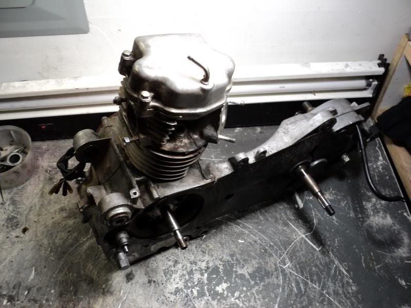

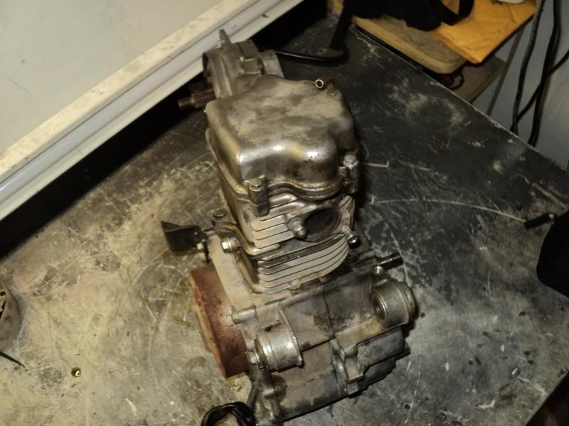

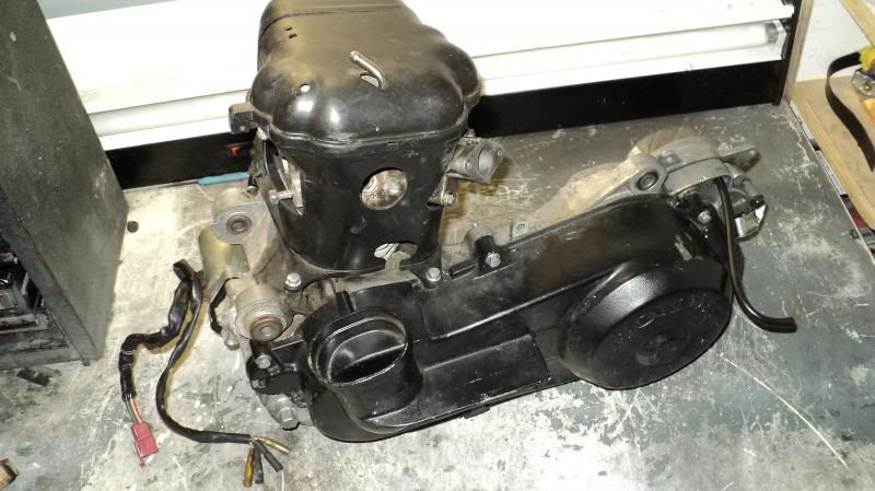

Now that it's winter and I'm not doing any riding I have the time to work on my scooters. I'm tearing down my spare ch80 engine to do some porting. There's no information online about internal engine mods for the ch80, so this will be experimental. I plan on taking a lot of pics, stay tuned...
Here's the ch80, starting to take it apart.
