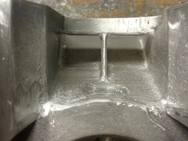

All looks pretty good man nice work. On the intake I would bring the center piece to a knifes edge so it doesn't block so much flow. And there is a little triangle just past the intake windows towards the front of the motor that messes with airflow from the transfer ports. Did you get that smoothed out? It kinda looks like it but hard to tell from pics.

I will take a look at that area. I didn't touch things there because I wasn't sure where the crank is gonna top out. From what I understand, you don't want the transfers moving mixture too low. I wasn't sure whether I should rough up the intake side transfer or smooth it out. Just like knife-edging, smooth vs. rough is debatable. It seems to me that polished would be ideal, but im open to suggestions in this area.

I leave my entire intake track from the intake its self all the way to the crank with a cats tongue roughness. You want the fuel and oil to catch and mix together. I believe this is what most people will say. If it's polished nothing will stick. I'm sure there's more to it but that's just what I've learned.

Here's the best pic I have from my stroker intake. It's nice like a sandpaper roughness and I shaved both sides for the center post to a edge.
Re: Stock boost channel
I guess I can go higher on my intake bridge. (I threw a quick knife edge before snapping the pic)

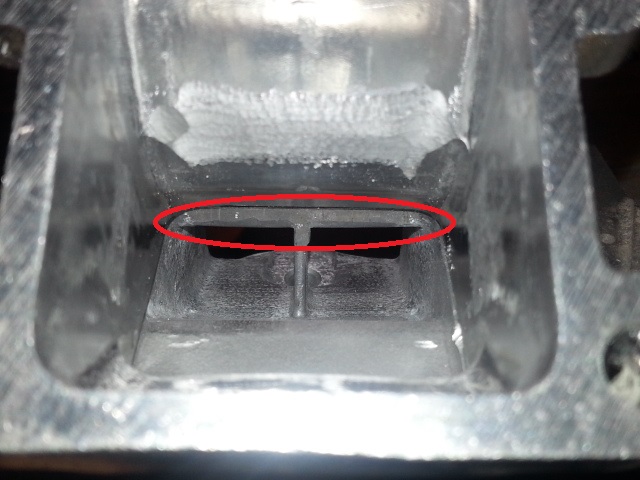

Thanks! I was looking at the way the CT manifold mates to the intake earlier today, and noticed that if I wanted a completely smooth transition into it, I would have to bring the bridge of the cases intake almost all the way up. Now that I can see curtis' intake and how much higher he brought his up in the rear, I'm thinking I may angle the front of the bridge all the way up to the CT and leave the back thick for support.

Re: Boost and intake modifications
A CT manifold mating with dio cases. You guys think I could cut the bridge up that high in the front, then leave the back full and have enough support?
Mine is cut all the way to match with the ct. Just like your talking about.

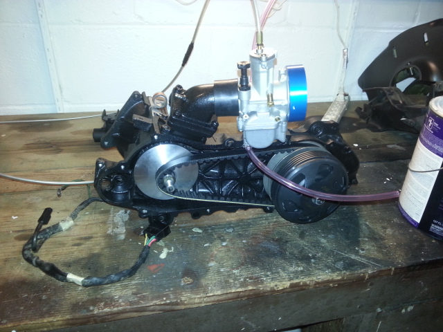

Well, I'd like to post pics up, but the ct manifold is mounted so I cant show what I really want to. The area circled red in the above pic was smoothed to flow with the manifold. My cases are together now, but I havent mounted my cylinder yet. Im not gonna mount the cylinder until I get the pipe from g9 cause im gonna mount the flange of the pipe first, then smooth it so the cylinder to pipe transition is flawless. So here's my parts list;
-ported fabrizi 189 exhaust, 125 transfers and boost
-flowed cases, boost and transfers matched
-malossi crank
-malossi cdi
-polini for ruckus vario
-zx trans rear pulley
-polini 3 shoe clutch and sexy bell
-ct manifold with Naraku reedblock
-polini 26mm pwk flatslide
I've also got some cosmetics to sex it up....jdm tail, pg brake levers, black metropolitan rims with fresh rubber.
My plastics are beat. I proxies the cracks, sanded and painted them, but theyre so damaged they still look like poo.
Stock gears for now. I did a little research and I was meaning to ask trafficjamz to run some math for me. The stock elite gearing is around 12:1. I was happy with my stock zuma final reduction of 13:1. I understand though that the zuma runs a larger rear wheel, so final reduction doesn't actually have the final say.
