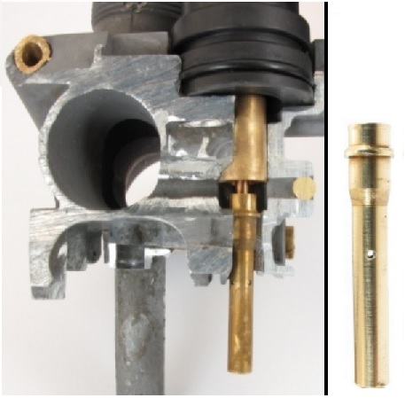

Well guys, I'm not really sure if I can drill/grind the bulge out. I was looking today and it looks like I'd hit the brass tube that the bystarter's needle goes into. Does anyone have any other ideas on fixing this?

The bystarter tube can be pressed out from behind (the carb bowl side).

> mw: The bystarter tube can be pressed out from behind (the carb bowl side).
>>> How do I get the tiny c-clip out to be able to push the tube out?
c-clip :?: Here's a pic
>>Also how do I tell if I have a nb50, nq50, etc.? or are they all the same?
Your carb is an NQ50 type, the bystarter is on the other side for an NB50.

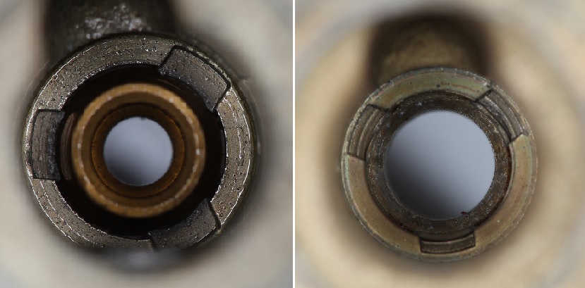

Clem, thanks for the advice. I have access to a nice drill press so I was going to go that route, but only if I got the brass emulsion tube out. To get the brass tube out I gave it a few taps with the back end of my screwdriver and it popped out.
I don't know what the thing in the bottom of the tube is, or what it is for.
Re: Dies after hitting bumps
Posted: Fri Nov 22, 2013 9:07 am

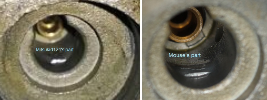

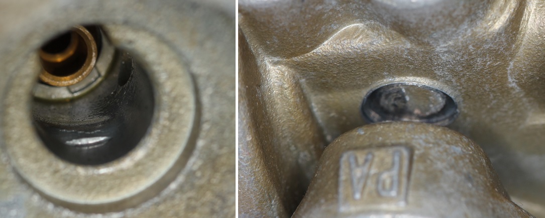

I looked through more than a half dozen carbs w/o finding a clip and don't recall any clips on dozens of other carbs.
There is a detail on the casting looking like your posting.
Pats fiche was reviewed, there is no replacement part installed into the bottom of the bystarter recess.
Also, made a comparison between your posted photo vs a pic of the same angle of a carb in the mouse garage. Our carb bodies appear the same.
Question: Was the black part you posted an actual component within your carb?

I guess I just haven't been able to get as clear of a look as you got in your pictures mouse. To me it looked like a clip or something but I guess it is just the casting that I'm seeing. thanks for the higher quality pictures mouse!
As far as the other picture you compared to mine, on your carb by chance is there a mark from a bolt like the bottom pic in my post from the 19th? On my carb I figure that the wall was thin enough for the casting to be pushed in causing that bubble. Mine definitely has a mark from too long of a bolt, and that's what I think cause mine to do that.
let me know mouse.
Posted: Fri Nov 22, 2013 10:21 pm
Hi mitsukid124,
You are correct in diagnosis and that you see a carb close to yours. The bystatrter air valve posted is definitely tagged by an improper bolt. Thanks for pics of issues you found, your thread will be helpful for future members :thumbsup:
