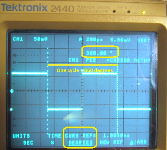

One way is with an oscilloscope. The measurement is basic electronics - here's a tutorial link http://www.wisc-online.com/Objects/View ... ID=ACE3803. I I use a Tektronix digital storage scope which computes degrees. A simple degree measurement is shown below.

An oscilloscope simply measures voltage and time, in order for it to record the timing map the actual crankshaft position and degrees would need a base line setting. I would imagine a crankshaft position sensor would need to be added to gather data. But then again, I am hoping someone will already know how this needs to be done.
A) Sure - yet right now we don't need an absolute map.
B) Even if we have a full map, finding a CDI to match other than the Aero may not pan out.
-- Working plan --
1) Foster reproduction of results. This must be reproduced on a members Spree. As seen in this site or thread, many have tried CDI's with adjustable or 'racing' maps with zero to minor gains.
2) I will measure deltas between 83/84 Aero vs Spree CDI (1986-87 to match your model). No crank sensor required.
3) Two thumbs up? I will add a crank sensor for TDC and capture absolute data.
Edit: Add
Why not use the method on old cars?
Put a mark at TDC on the flywheel, make a +/- degree scale to mount on the crankcase and use a timing light and tach.
