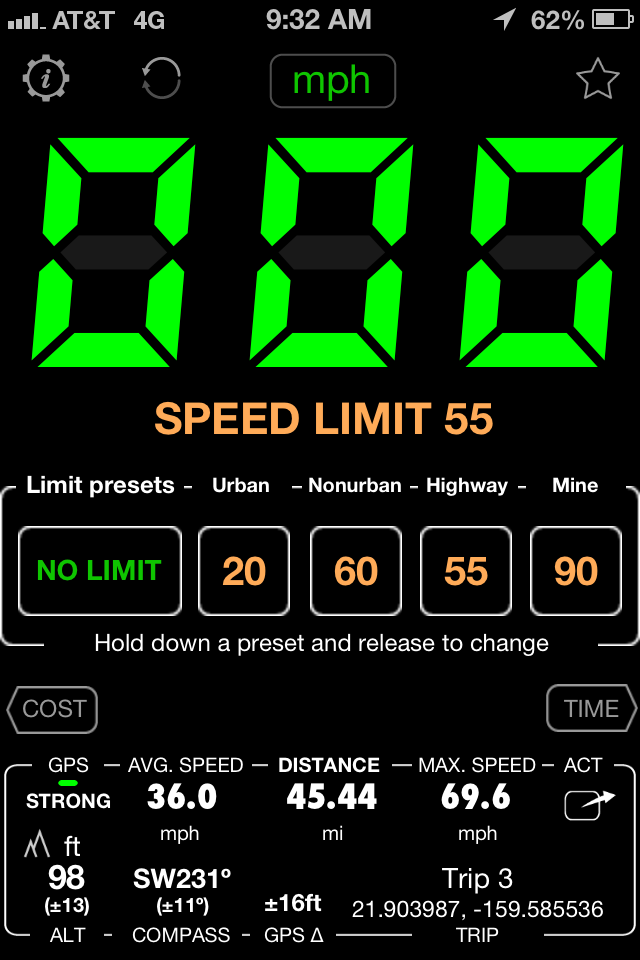

ahh ok i thought you would be hitting higher then that...i got mines up to 69mph it has alot of power off the line. he wheelies easy and its a sym... jus thought would have more action with da mini
bottom right is top speed
