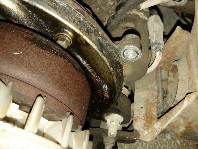

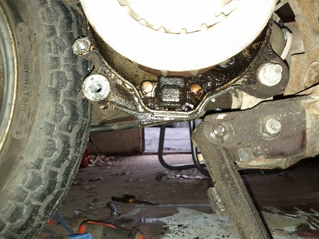

Ok guys, heres the *,
I was in the process of removing the fan shroud and top cover in order to get to the manifold, and I noticed something that I was too dumb to see before, oil behind the flywheel near the bottom, where presumably the bottom of the crankshaft is.
I included pics of the leak, and I assumbe that you were right, that I had a slow leak over time, and that extended riding either aggravated the oil pump leak, or finally got up and fouled the plug. If you guys confirm through the pics that this IS a oil leak in the crankshaft, where do I go from here? Do I take the oil pump off and replace? I will obviously clean up down there, but do I need to check anything else?

Not an oil pump issue. That is a crank seal issue.

Back to square one, lol now what? Whould a leaking crankshaft seal contribute to my problem?

The over filling of the cases could have caused a crank leak. Remove the spark plug, crank the engine. If oil comes out, you have answered your question. Replace with a new plug when the oil stops coming out. When she cranks over, expect A LOT OF SMOKE!

on the down strok of the motor the case come under pressure and if the seal is bad it will let some mix out of the case and on the up strok it will suck in air.. you shod look at both ends of the crank to see if the oil is comming from the seals .. or were it comming from ???

Crank seals are fairly inexpensive - get your manual out and see where they are - one on each side. It is obviously leaking on the flywheel side but it may also be leaking on the variator side. Probably want to replace both just so you don't have to worry about it. You'll need a flywheel puller to remove the flywheel (probably) and you'll want to read up about the left side cover and what's underneath. It really isn't a big job if you read thru the forum and your manual first. Also remember that you still need to find out if the pump is leaking - follow Marty's advice there.
1) Follow Marty's advice pulling the plug...
2) Remove the oil pump, and find out if it is leaking (almost certainly is if oil comes out when turning over in step 1)
3) Order 2 seals, flywheel puller, new plug, and find a replacement pump if needed - you'll also need a tool to hold the flywheel (on right side) or variator (on left side) in order to remove the nut on the flywheel and variator.
4) While you're waiting, read thru the forum on removing the variator, flywheel, etc. - also some good tips on pulling the seals out. Also look thru manual for these processes
5) When you get your parts and tools, you should be able to replace the seals, put in a new pump, bleed the pump lines, and install a new plug in an afternoon
