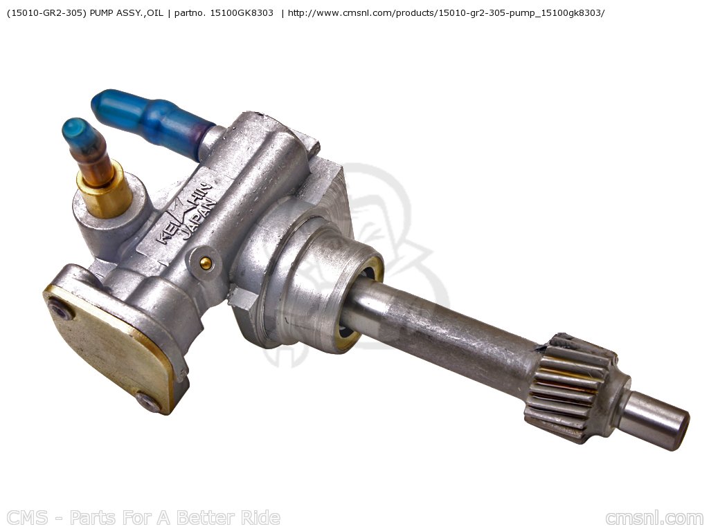

Ok, I just came up with an idea while searching for ways to plug up the hole where the oil pump resides.
Can I just melt the ends of the two tubes that come out of the spree's oil pump?
Wouldn't this retain the compression in the oil pump?

What are you going to do when the oil pump seizes up?jokim00 wrote:Ok, I just came up with an idea while searching for ways to plug up the hole where the oil pump resides.

heres the deal the oil pump is ran my the crank ..so if you do what your thinking the pump will still run with no oil ( no you cant just put oil in the hose and it will work... not ) and heat up and seizes up (stop ) then it will muck up you crank and the motor will be junk .. or you cood do what ill bet someone has said and grind the teeth off the oil pump put it back in and mix the oil in the tank and get on with it..

You should still block the oil in/out nipples after you grind off the gears to prevent small air leaks.

What's a good tool to use to grind off the gears?
Should I go to a shop for this?

bench grinder
